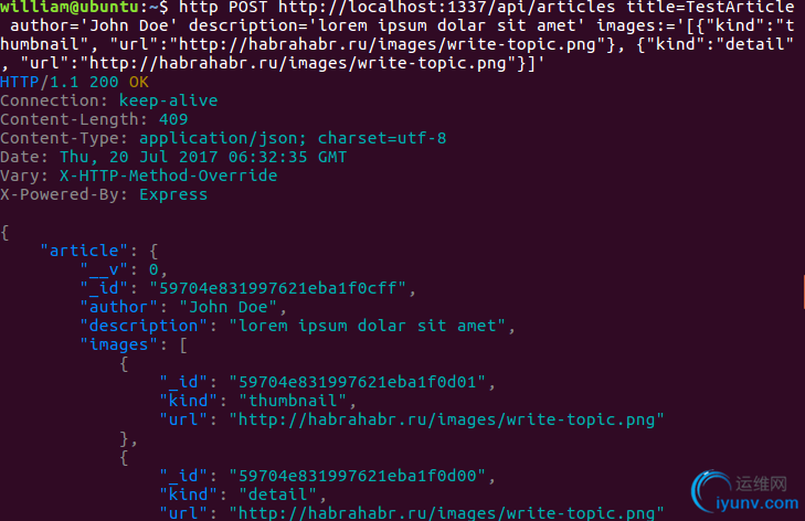

  怎么用HttpIE去调试API呢,比如我需要调试添加一条article记录怎么办呢? http://localhost:1337/api/articles,
$ http POST http://localhost:1337/api/articles title=TestArticle author='John Doe' description='lorem ipsum dolar sit amet' images:='[{"kind":"thumbnail", "url":"http://habrahabr.ru/images/write-topic.png"}, {"kind":"detail", "url":"http://habrahabr.ru/images/write-topic.png"}]'
  看截图:

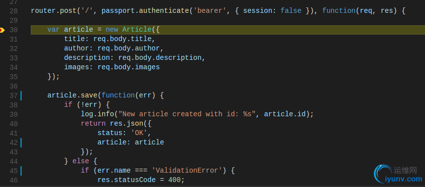

  然后进入到了virtual studio code里面的断点:
