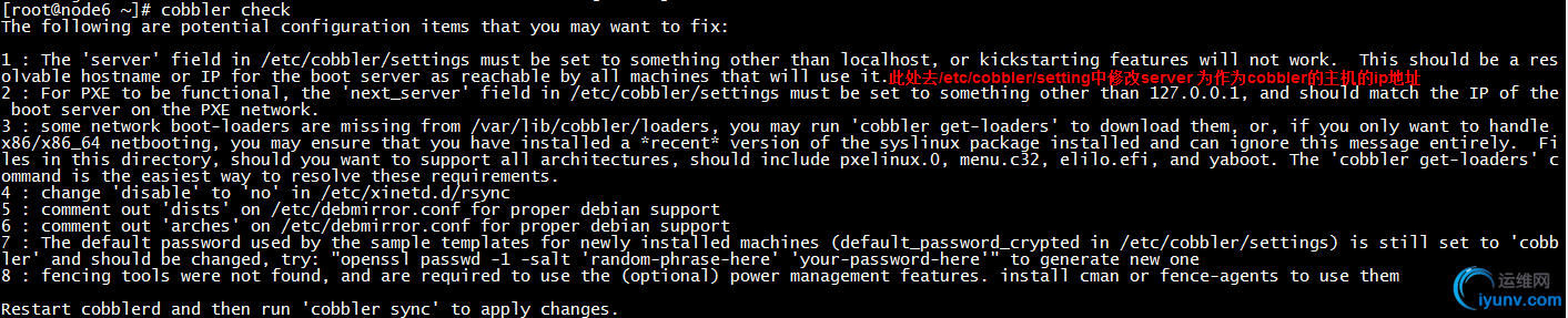

  • [iyunv@node6 ~]# cobbler check
  • The following are potential configuration items that you may want to fix:
  • 1 : The 'server' field in /etc/cobbler/settings must be set to something other than localhost, or kickstarting features will not work.  This should be a resolvable hostname or IP for the boot server as reachable by all machines that will use it. 将/etc/cobbler/setting中的server改为cobbler主机的地址
  • 2 : For PXE to be functional, the 'next_server' field in /etc/cobbler/settings must be set to something other than 127.0.0.1, and should match the IP of the boot server on the PXE network.
  • ##将/etc/cobbler/setting中的next-server改为cobbler主机的地址

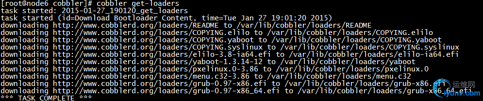

  • 3 : some network boot-loaders are missing from /var/lib/cobbler/loaders, you may run 'cobbler get-loaders' to download them, or, if you only want to handle x86/x86_64 netbooting, you may ensure that you have installed a *recent* version of the syslinux package installed and can ignore this message entirely.  Files in this directory, should you want to support all architectures, should include pxelinux.0, menu.c32, elilo.efi, and yaboot. The 'cobbler get-loaders' command is the easiest way to resolve these requirements.
  • ##此处可通过命令cobbler get-loaders修复,需要联网下载
  • 4 : change 'disable' to 'no' in /etc/xinetd.d/rsync 修改/etc/xinetd.d/rsync中的disable为no
  • 5 : comment out 'dists' on /etc/debmirror.conf for proper debian support
  • 6 : comment out 'arches' on /etc/debmirror.conf for proper debian support ##注释掉/etc/debmirror.conf中@distshearches开头的行
  • 7 : The default password used by the sample templates for newly installed machines (default_password_crypted in /etc/cobbler/settings) is still set to 'cobbler' and should be changed, try: "openssl passwd -1 -salt 'random-phrase-here' 'your-password-here'" to generate new one 使用openssl passwd -1 -salt `openssl rand -hex 4` '你的密码',然后将生成的密码替换/etc/cobbler/setting文件中default_passwd_crypted后面的密码
如果显示一下图片所示则表示一切正常

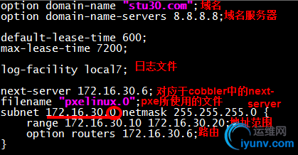

配置dncp服务器,此为最简单配置,172.16.30.6为本机地址
启动dhcpd服务
sevice dhcpd start

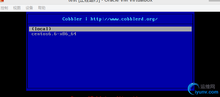

新建虚拟机测试
