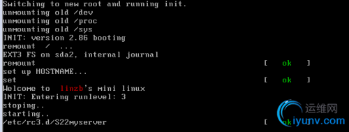

  这里只定义两个函数,为的是使开机流程看起来更像centos,内容如下:
  success(){
  STRING=$1
  OK="[ \033[32m  ok \033[0m  ]"
  ALL=`stty -F /dev/console size|awk '{print $2}'`
  SPA=$[$ALL-${#STRING}-${#OK}]
  echo -n "$STRING"
  for i  in `seq 1 $SPA`
  do
  echo  -n " "
  done
  echo  -e  "$OK"
  failed(){
  STRING=$1
  FAILED="[\033[31m failed \033[0m]"
  SPA=$[$ALL-${#STRING}-${#FAILED}]
  echo -n "$STRING"
  do
  echo  -n " "
  done
  echo  -e  "$FAILED"
  err_check(){
  if [ $? -eq 0 ];then
  success $1
  else
  failed $1
  fi
  修改rc.sysinit如下:
  #!/bin/bash
  . /etc/init.d/functions
  echo "remount  /  ..."
  mount -o remount,rw  /
  err_check "remount  / ..."
  echo -e "set up HOSTNAME..."
  if [ -f /etc/sysconfig/network ]; then
  . /etc/sysconfig/network
  fi
  if [ -z "$HOSTNAME" -o "$HOSTNAME" = "(none)" ]; then
  HOSTNAME=localhost
  fi
  hostname  $HOSTNAME
  err_check "set up HOSTNAME..."
  echo -e "Welcome to \033[31m linzb\033[0m's mini linux"
  效果如下图:

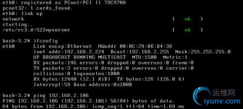

  6. 给mini linux配置网络功能
  首先要装载网卡驱动模块,因为实在虚拟机操作的,网卡类型为pcnet32,pcnet32又依赖于mii模块(可以用modinfo pcnet32查看),所以要装载两个模块
  编辑/mnt/sysroot/etc/sysconfig/network-scripts/ifcfg-eth0 文件内容如下:
  DEVICE=eth0
  BOOTPROTO=static
  HWADDR=00:0C:29:5B:58:99
  ONBOOT=yes
  IPADDR=192.168.2.224
  GATEWAY=192.168.2.1
  NETMASK=255.255.255.0
  编辑启动脚本/mnt/sysroot/etc/init.d/network,内容如下:
  #!/bin/bash
  #chkconfig:3 20 79
  #description:network config
  . /etc/sysconfig/network-scripts/ifcfg-eth0
  LOCK_FILE=/var/lock/subsys/network
  start(){
  echo "starting  network  config ... "
  touch $LOCK_FILE
  insmod  /lib/modules/mii.ko
  insmod  /lib/modules/pcnet32.ko
  ifconfig $DEVICE $IPADDR  netmask $NETMASK up
  route add default gw $GATEWAY
  err_check "network starting.."
  stop(){
  echo "stopping network ...."
  rm  $LOCK_FILE
  modprobe -r pcnet32.ko
  modprobe -r mii.ko
  err_check "network stopping.."
  status(){
  if [ -f $LOCK_FILE ] ;then
  echo  "network working ..."
  else
  echo  "network stopped.."
  fi
  case $1 in
  start)
  start ;;
  stop)
  stop ;;
  restart)
  stop
  start;;
  status)
  status;;
  echo "Usage: $0 [start|stop|status|restart]";;
  esac
  chmod +x给network执行权限,并用chkconfig创建启动级别软连接(这个要chroot 到/mnt/sysroot再执行,自己手动会有错),最终效果如下:
  注:
  如果启动过程包device no found 看看是否有挂载网卡,这个network脚本是stop不了的,模块无法卸载会报modprobe: FATAL: Could not load /lib/modules/2.6.8.custem/modules.deb的错,把modprobe -r改成rmmod命令后成功解决
