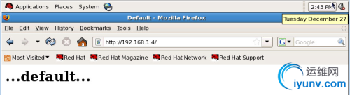

3)Virtual Hosts
  990 #NameVirtualHost *:80
  如果启用虚拟主机的话,必须将前面的注释去掉,而且,第二部分的内容都可以出现在每个虚拟主机部分。
998 # VirtualHost example:
1003 #<VirtualHost *:80>
1004 #    ServerAdmin webmaster@www.linuxidc.com
1005 #    DocumentRoot /www/docs/www.linuxidc.com
1006 #    ServerName www.linuxidc.com
1007 #    ErrorLog logs/www.linuxidc.com-error_log
1008 #    CustomLog logs/www.linuxidc.com-access_log common
1009 #</VirtualHost>

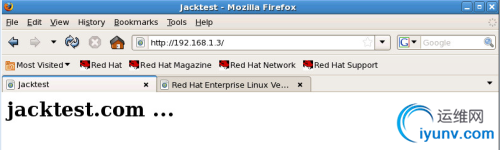

  三、配制站点
  [root@test conf]# mkdir -pv /www/{jacktest.com,a.org,bbs.net,d.gov}
mkdir: created directory `/www'
mkdir: created directory `/www/jacktest.com'
mkdir: created directory `/www/a.org''
mkdir: created directory `/www/bbs.net'
mkdir: created directory `/www/d.gov'
  [root@test www]# cat a.org/index.html
<title>A</title>
<h1>a.org<h1>
[root@test www]# cat bbs.net/index.html
<title>BBS<title>
<h1>bbs.net<h1>
[root@test www]# cat d.gov/index.html
<title>D</title>
<h1>d.gov<h1>
  [root@test httpd]# cat /www/jacktest.com/index.html
<title>Jacktest</title>
<h1>jacktest.com   ...<h1>
  [root@test httpd]# vi conf.d/virtual.conf
NameVirtualHost 192.168.1.4:80
<VirtualHost 192.168.1.4:80>
    ServerName  www.a.org
    DocumentRoot "/www/a.org"
</VirtualHost>
    ServerName  www.d.gov

<VirtualHost 192.168.1.3:80>
    ServerName Hello.jacktest.com
    DocumentRoot "/www/jacktest.com"
</VirtualHost>

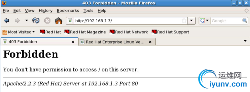

  五、设置站点访问控制
  [root@test conf.d]# vim /etc/httpd/conf.d/virtual.conf
        CustomLog /var/log/httpd/jacktest.com/access_log combined
          <Directory "/www/jacktest.com">
              Option none
              AllowOverride none
              Order deny,allow
              Deny from 192.168.1.5
          </Directory>
  </VirtualHost>

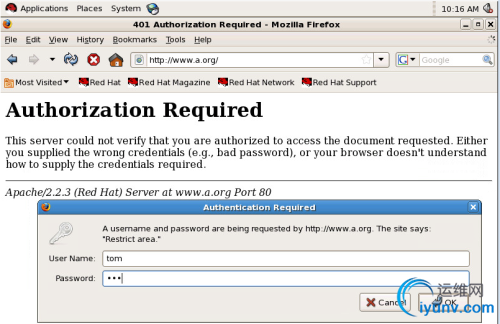

  六、设置站点加密访问
        CustomLog /var/log/httpd/a.org/access_log combined
        <Directory "/www/a.org">
            Options none
            AllowOverride authconfig
            AuthType basic
            AuthName "Restrict area."
            AuthUserFile "/etc/httpd/.htpasswd"
            Require valid-user
        </Directory>
  #只加密这一个网站
</VirtualHost>
  [root@test conf.d]# htpasswd -c -m /etc/httpd/.htpasswd jerry
New password:
Re-type new password:
Adding password for user jerry
[root@test conf.d]# htpasswd  -m /etc/httpd/.htpasswd tom
  [root@test conf.d]# httpd -t
Syntax OK
  [root@test conf.d]# service httpd restart
Stopping httpd:                    [  OK  ]
Starting httpd:                     [  OK  ]

  六、设置默认站点
        ServerName _default_
        DocumentRoot "/www/default"
</VirtualHost>
  [root@test conf.d]# vim /www/default/index.html
<title>Default</title>
<h1>...default...<h1>

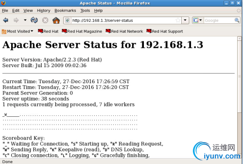

  七、设置网页查看服务器状态信息
  [root@test conf.d]# vi /etc/httpd/conf/httpd.conf
  <Location /server-status>
    SetHandler server-status
    Order allow,deny
    Allow from all
</Location>
