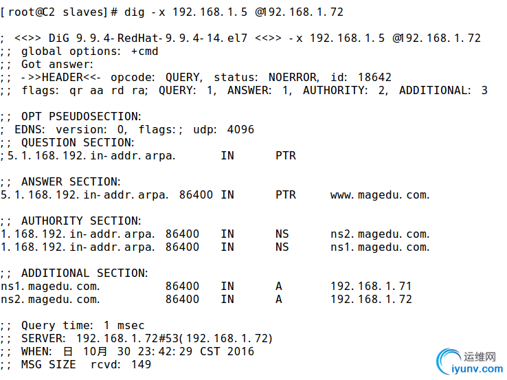

include "/etc/named.root.key";        编辑/etc/named.rfc1912.zones,添加以下区域:
zone "1.168.192.in-addr.arpa" IN {
    type master;
    file "192.168.1.zone";
allow-update { none; };
zone "magedu.com" IN {
    type master;
    file "magedu.com.zone";
    allow-query { any; };
    allow-transfer { slaves; };            //接受“slaves”传输请求
};    添加区域资源记录:
        正向资源记录:
# cat magedu.com.zone
$TTL 1D
$ORIGIN magedu.com.
@       IN      SOA     ns1.magedu.com.     admin.magedu.com    (
                        2016103002
                        1H
                        5M
                        7D
                        1D )
        IN      NS      ns1
        IN      NS      ns2
        IN      MX  10  mx1
        IN      MX  20  mx2
ns1     IN      A       192.168.1.71
ns2     IN      A       192.168.1.72
mx1     IN      A       192.168.1.100
mx2     IN      A       192.168.1.200
www     IN      A       192.168.1.5
cdn     IN      NS      ns.cdn
ns.cdn  IN      A       192.168.1.61
*       IN      A       192.168.1.100        反向资源记录:
# cat 192.168.1.zone
$TTL 1D
$ORIGIN 1.168.192.in-addr.arpa.
@       IN      SOA     ns1.magedu.com.     admin.magedu.com.    (
                        2016103001
                        1H
                        5M
                        7D
                        1D )
        IN      NS      ns1.magedu.com.
        IN      NS      ns2.magedu.com.
71      IN      PTR     ns1.magedu.com.
72      IN      PTR     ns2.magedu.com.
100     IN      PTR     mx1.magedu.com.
200     IN      PTR     mx2.magedu.com.
5       IN      PTR     www.magedu.com.

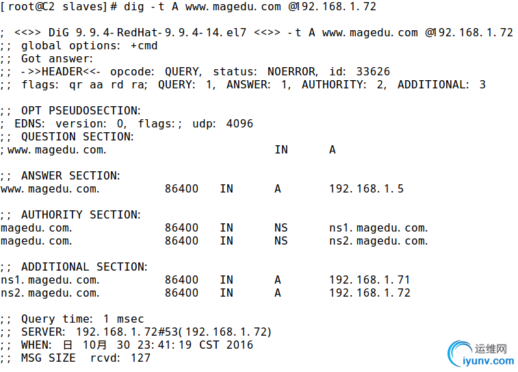

61      IN      PTR     ns.cdn.magedu.com.    辅助名称服务器(192.168.1.72):
        /etc/named.conf:
options {
listen-on port 53 { 127.0.0.1; 192.168.1.72; };
//listen-on-v6 port 53 { ::1; };
directory "/var/named";
dump-file "/var/named/data/cache_dump.db";
statistics-file "/var/named/data/named_stats.txt";
memstatistics-file "/var/named/data/named_mem_stats.txt";
logging {
        channel default_debug {
                file "data/named.run";
                severity dynamic;
zone "." IN {
type hint;
file "named.ca";
include "/etc/named.rfc1912.zones";
include "/etc/named.root.key";        /etc/named.rfc1912.zones添加以下部分:
    type slave;
    masters { 192.168.1.71; };
    file "slaves/magedu.com.zone";
    type slave;
    file "slaves/192.168.1.zone";

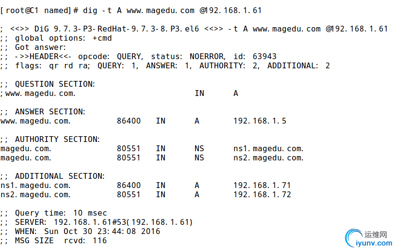

};    cdn.magedu.com子域服务器(192.168.1.61):
        /etc/named.conf:
options {
listen-on port 53 { 127.0.0.1; 192.168.1.61; };
recursion yes;
    forward first;                //定义全局转发服务器,当主服务器不予递归时再将请求转发至根域服务器
    forwarders { 192.168.1.71; };
logging {
                severity dynamic;
zone "." IN {
type hint;
file "named.ca";
include "/etc/named.rfc1912.zones";        /etc/named.rfc1912.zones
zone "cdn.magedu.com" IN {
    type master;
    file "cdn.magedu.com.zone";
//zone "magedu.com" IN {            //定义区域转发服务器,与全局转发选其一。区域转发只转发magedu.com域的请求
//    type forward;
//    forward only;
//    forwarders { 192.168.1.71; 192.168.1.72; };
//};          /var/named/cdn.magedu.com.zone:
$TTL 1D
$ORIGIN cdn.magedu.com.
@       IN      SOA     ns.cdn.magedu.com.      admin.cdn.magedu.com.   (
                        2016103001
                        1H
                        5M
                        7D
                        1D )
        IN      NS      ns
        IN      MX  10  mx
ns      IN      A       192.168.1.61
mx      IN      A       192.168.1.101
www     IN      A       192.168.1.110
*       IN      A       192.168.1.111

    测试辅助服务器正反解析:
    测试子域服务器:

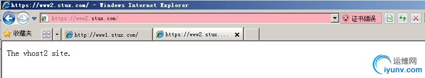

6、建立httpd服务器(基于编译的方式进行),要求:
提供两个基于名称的虚拟主机:
(a)www1.stuX.com,页面文件目录为/web/vhosts/www1;错误日志为/var/log/httpd/www1.err,访问日志为/var/log/httpd/www1.access;
(b)www2.stuX.com,页面文件目录为/web/vhosts/www2;错误日志为/var/log/httpd/www2.err,访问日志为/var/log/httpd/www2.access;
(c)为两个虚拟主机建立各自的主页文件index.html,内容分别为其对应的主机名;
(d)通过www1.stuX.com/server-status输出httpd工作状态相关信息,且只允许提供帐号密码才能访问(status:status);
  在RHEL6上编译安装httpd2.4

7、为第6题中的第2个虚拟主机提供https服务,使得用户可以通过https安全的访问此web站点;
(1)要求使用证书认证,证书中要求使用的国家(CN)、州(HA)、城市(ZZ)和组织(MageEdu);
(2)设置部门为Ops,主机名为www2.stuX.com,邮件为admin@stuX.com;
  1. 创建私有CA服务器
  (1) 根据openssl配置文件(/etc/pki/tls/openssl.cnf)准备CA服务器环境:
[root@C1 ~]# cd /etc/pki/CA/ //切换到CA根目录
[root@C1 CA]# touch index.txt //创建证书数据库索引文件
[root@C1 CA]# echo 01 > serial //设置当前证书(第一个)序列号  (2) 生成CA的私钥
[root@C1 CA]# (umask 077; openssl genrsa -out /etc/pki/CA/private/cakey.pem 2048)
Generating RSA private key, 2048 bit long modulus
e is 65537 (0x10001)  (3) 生成CA自签证书
[root@C1 CA]# openssl req -new -x509 -key /etc/pki/CA/private/cakey.pem -days 3650 -out /etc/pki/CA/cacert.pem
You are about to be asked to enter information that will be incorporated
into your certificate request.
What you are about to enter is what is called a Distinguished Name or a DN.
There are quite a few fields but you can leave some blank
For some fields there will be a default value,
If you enter '.', the field will be left blank.
Country Name (2 letter code) [XX]:CN
State or Province Name (full name) []:HA
Locality Name (eg, city) [Default City]:ZZ
Organization Name (eg, company) [Default Company Ltd]:MageEdu
Organizational Unit Name (eg, section) []:Ops
Common Name (eg, your name or your server's hostname) []:ca.stuX.com
Email Address []:admin@stuX.com  (4) 检查CA自签证书内容:
[root@C1 CA]# openssl x509 -in /etc/pki/CA/cacert.pem -noout -subject
subject= /C=CN/ST=HA/L=ZZ/O=MageEdu/OU=Ops/CN=ca.stuX.com/emailAddress=admin@stuX.com  2. http服务器申请签署证书
  (1) 客户端生成证书签署请求:
[root@C1 ~]# mkdir /etc/httpd24/ssl
[root@C1 ~]# cd /etc/httpd24/ssl
[root@C1 ssl]# (umask 077; openssl genrsa -out httpd.key 2048)
[root@C1 ssl]# openssl req -new -key httpd.key -days 3650 -out httpd.csr
Common Name (eg, your name or your server's hostname) []:www2.stuX.com
Please enter the following 'extra' attributes
to be sent with your certificate request
A challenge password []:
An optional company name []:  (2) 将证书签署请求发送给CA(RA):
[root@C1 ssl]# scp httpd.csr root@192.168.1.97:/tmp  (3) CA为http服务器签署证书:
[root@C1 CA]# openssl ca -in /tmp/httpd.csr -days 3650 -out /etc/pki/CA/certs/httpd.crt
Using configuration from /etc/pki/tls/openssl.cnf
Check that the request matches the signature
Signature ok
Certificate Details:
        Serial Number: 1 (0x1)
        Validity
            Not Before: Nov 17 09:22:25 2016 GMT
            Not After : Nov 15 09:22:25 2026 GMT
        Subject:
            countryName               = CN
            stateOrProvinceName       = HA
            organizationName          = MageEdu
            organizationalUnitName    = Ops
            commonName                = www2.stuX.com
            emailAddress              = admin@stuX.com
        X509v3 extensions:
            X509v3 Basic Constraints:
                CA:FALSE
            Netscape Comment:
                OpenSSL Generated Certificate
            X509v3 Subject Key Identifier:
                BD:64:23:20:D3:3B:79:0C:C4:2B:AB:F4:47:84:6F:54:38:78:68:5B
            X509v3 Authority Key Identifier:
                keyid:C1:CA:83:F5:FA:CC:BA:15:CE:BC:D2:A1:13:1D:6F:17:5F:C9:59:0C
Certificate is to be certified until Nov 15 09:22:25 2026 GMT (3650 days)
Sign the certificate? [y/n]:y
1 out of 1 certificate requests certified, commit? [y/n]y
Write out database with 1 new entries
Data Base Updated  (4) 检查http服务器证书,并将该证书传递给http服务器:
[root@C1 CA]# openssl x509 -in /etc/pki/CA/certs/httpd.crt -noout -subject
subject= /C=CN/ST=HA/O=MageEdu/OU=Ops/CN=www2.stuX.com/emailAddress=admin@stuX.com
[root@C1 CA]# scp /etc/pki/CA/certs/httpd.crt root@192.168.1.83:/etc/httpd24/ssl/  #重启名虚拟主机的证书和私钥文件,以便后期引用:
[root@C1 ~]# cd /etc/httpd24/ssl/
[root@C1 ssl]# mv httpd.crt www2.stuX.com.crt
[root@C1 ssl]# mv httpd.key www2.stuX.com.key  3. 配置http服务器使用证书使之支持https
  (1) 为httpd安装mod_ssl模块:
[root@C1 ~]# yum install -y mod_ssl  (2)检查httpd主配置文件/etc/httpd24/httpd.conf是否存在并启用以下条目:
LoadModule ssl_module modules/mod_ssl.so
LoadModule socache_shmcb_module modules/mod_socache_shmcb.so
Include /etc/httpd24/extra/httpd-ssl.conf  (3) 修改ssl相关的配置文件/etc/httpd24/extra/httpd-ssl.conf:
[root@C1 extra]# egrep -v '^#|^$' httpd-ssl.conf
Listen 443
SSLCipherSuite HIGH:MEDIUM:!MD5:!RC4
SSLProxyCipherSuite HIGH:MEDIUM:!MD5:!RC4
SSLHonorCipherOrder on
SSLProtocol all -SSLv3
SSLProxyProtocol all -SSLv3
SSLPassPhraseDialog  builtin
SSLSessionCache        "shmcb:/usr/local/httpd24/logs/ssl_scache(512000)"
SSLSessionCacheTimeout  300
<VirtualHost *:443>#定义基于443端口的虚拟主机
DocumentRoot "/web/vhosts/www2"
ServerName www2.stuX.com:443
ServerAdmin you@example.com
ErrorLog "/web/vhosts/www2.err"
TransferLog "/web/vhosts/www2.access"
SSLEngine on
SSLCertificateFile "/etc/httpd24/ssl/www2.stuX.com.crt"#指定www2.stuX.com.crt虚拟主机的证书文件

  4. 检查配置文件,重启服务并检查443端口:
[root@C1 ~]# httpd -t
Syntax OK
[root@C1 ~]# apachectl restart
[root@C1 ~]# ss -tanl | grep :443
0      128                           :::443                          :::*
  5. 测试:
