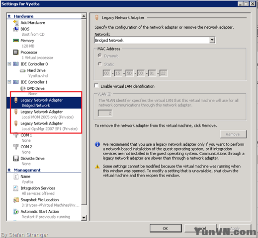

  • Configure the Vyatta Virtual Machine
    Add the Network Adapters for the Internet, and the needed subnets to Vyatta Virtual Machine.
    Remark: Use Legacy Network Adapters!
    I added a 1 GB harddisk and gave it 128 MB RAM.
