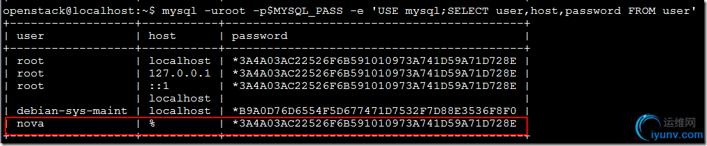

  4.5 添加nava数据库,并配置用于访问nova数据库的用户名和密码
  openstack@localhost:~$ MYSQL_PASS=${MYSQL_PASS:-&quot;openstack&quot;}
  openstack@localhost:~$ NOVA_MYSQL_USER=${NOVA_MYSQL_USER:-&quot;nova&quot;}
  openstack@localhost:~$ NOVA_MYSQL_PASS=${NOVA_MYSQL_PASS:-&quot;openstack&quot;}
  openstack@localhost:~$ mysql -uroot -p$MYSQL_PASS -e &quot;DROP DATABASE IF EXISTS ${NOVA_MYSQL_USER};&quot;
  openstack@localhost:~$ mysql -uroot -p$MYSQL_PASS -e &quot;CREATE DATABASE ${NOVA_MYSQL_USER};&quot;
  openstack@localhost:~$ mysql -uroot -p$MYSQL_PASS -e &quot;GRANT ALL PRIVILEGES ON ${NOVA_MYSQL_USER}.* TO '${NOVA_MYSQL_USER}'@'%'&quot;
  openstack@localhost:~$ mysql -uroot -p$MYSQL_PASS -e &quot;SET PASSWORD FOR '${NOVA_MYSQL_USER}'@'%' = PASSWORD('${NOVA_MYSQL_PASS}');&quot;
  4.6 检查前面配置是否成功
  openstack@localhost:~$ mysql -uroot -p$MYSQL_PASS -e 'USE mysql;SELECT user,host,password FROM user'

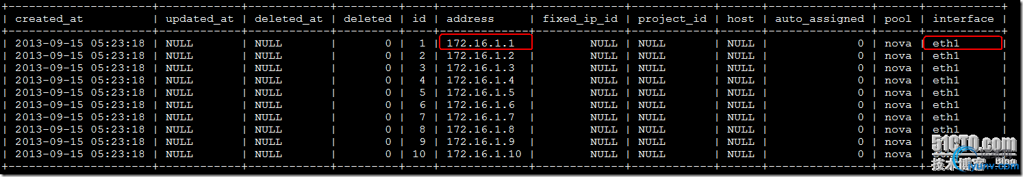

  openstack@localhost:~$ sudo nova-manage floating create --ip_range=172.16.1.0/24
  操作后执行下面的命令验证一下:
  openstack@localhost:~$ mysql -uroot -p${MYSQL_PASS} -e 'select * from nova.floating_ips limit 10'
