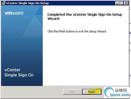

  Single Sign On installation / upgrade (Simple / custom)
In my lab I have all the roles on my same virtual machine (Single Sign-On, vSphere Web Client, vCenter Inventory Service, vCenter Server). In my production the roles are split up so I would then choose “custom”
Earlier version is detected and will be upgraded as per message. Make sure you have a backup before upgrading!
Important! SSO now relies heavily on DNS. As my previous installation was via IP it will prompt the warning message but also identify the FQDN for the virtual machine. To use this press “accept”
Enter SSO credentials
Select “install”

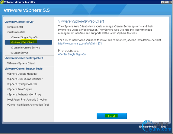

  VMware vSphere Web Client Upgrade
Lookup Service URL: https://vcenter_server(FQDN):7444/lookupservice/sdk

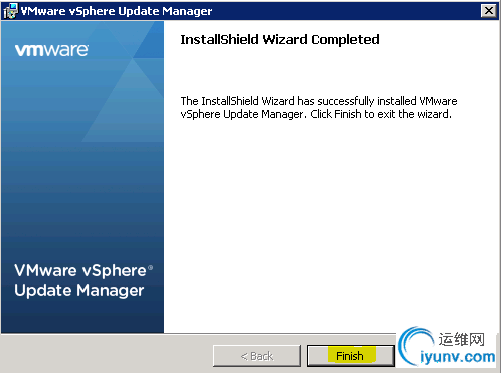

  VMware vSphere Update Manager Upgrade
Earlier version detected. Select “OK” to upgrade (backup)

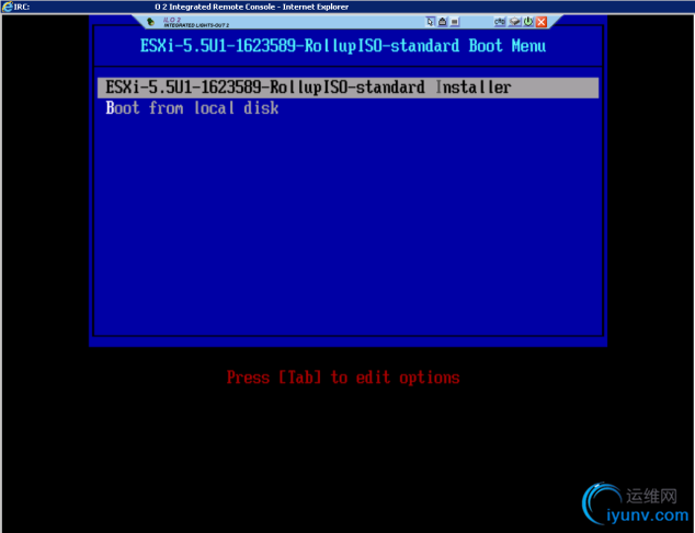

  VMware ESXi 5.1 upgrade

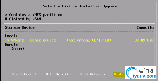

Host running on HP hardware so using iLO to remote in to upgrade the host. Attach .ISO and reboot host to get going (put host in maintenance mode before starting)!
Select “Upgrade ESXi, preserve VMFS datastore”
Warning message as I am using old hardware but we can still proceed with upgrade
Press “F11” to upgrade
When upgrade is done select “Enter” to reboot. Give the host time to boot up as it initializes. Do the same for all the remaining host. You can also utilize update manager by uploading the .ISO image and then upgrading the hosts.
