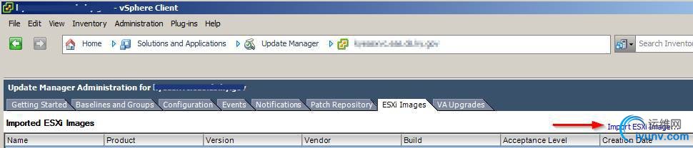

  •   Open the vSphere client and click on Update Manager
  •   First we’ll upload the ISO image. Click on the “ESXi Images” tab.
  •   Click on the “Import ESXi Image” link.
