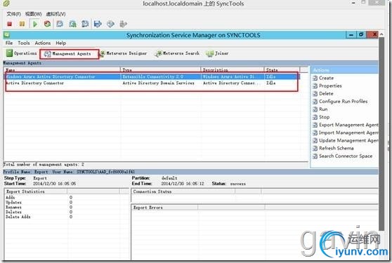

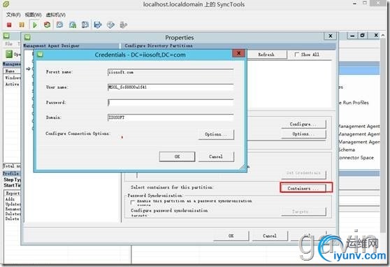

  In Identity Manager, click Management Agents, and then double-click Active Directory Connector.

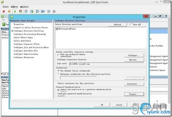

  Click Configure Directory Partitions, and then click Containers
  Note:When presented with the credentials dialog box, the MSOL_AD_Sync account will be displayed. This account is using a randomly generated password, so administrators will not know the password. When performing this filtering operation, you should enter an account which has access to the Active Directory forest. The account used here should be an Enterprise Admin. The Enterprise Admin account can view the entire forest and perform the filtering within any domain within the forest. Using a Domain Admin will limit the scope of what the Directory Synchronization tool can view and may not be viable when needing to expand the filter into other domains.
  所以我们再次输入域管理员账户及密码验证

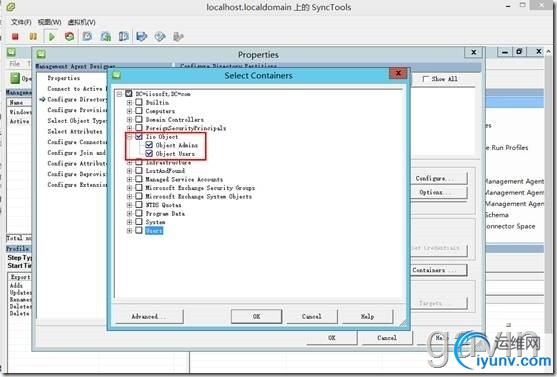

  In the Select Containers dialog box, clear the OUs that you don’t want to synch with the cloud directory, and then click OK. Click OK on the SourceAD Propertiespage
  Click ok

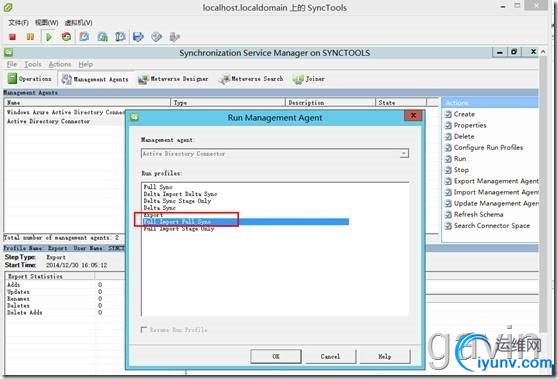

  Perform a full sync: on the Management Agent tab, right-click Active Directory Connector, click Run, click Full Import Full Sync, and then click OK.

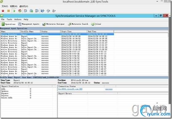

  开始sync
  同步完成:

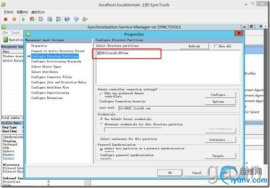

  3.In Identity Manager, click Management Agents, and then double-click Active Directory Connector.
  Click Configure Directory Partitions, and then select the domains that you want to synchronize. To filter a domain out of the synchronization process, clear the domain’s check box.

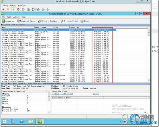

  4.同步时间
  我们最后通过log确认,dirsync默认的同步时间为3小时一次。
  如果我们在修改后的某个属性的话,需要理解生效的话,我们可以通过powershell进行强制同步。

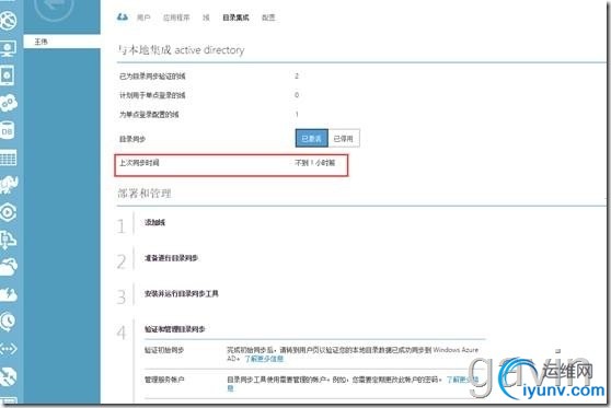

  然后我们通过start-onlinecoexistencesync来进行强制同步
  执行后,我们可以在windows azure portal页面上看见同步时间

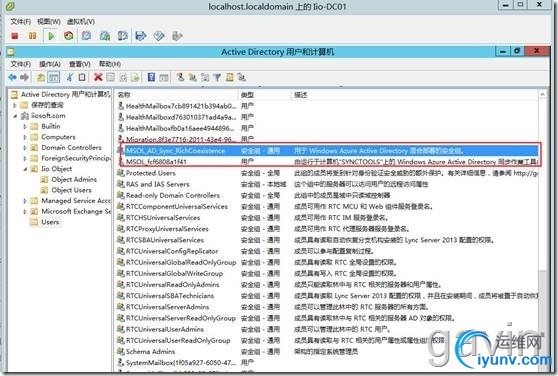

  我们最后再强调一个问题,在配置目录同步时,系统会在本地的Active Directorty林中创建一个同步用户组,用该服务器账户读取和同步你本地的Active directory信息。
  在为给订的云租户组织配置并同步该工具后,你无法配置同一目录同步安装来填充其他云租户。
