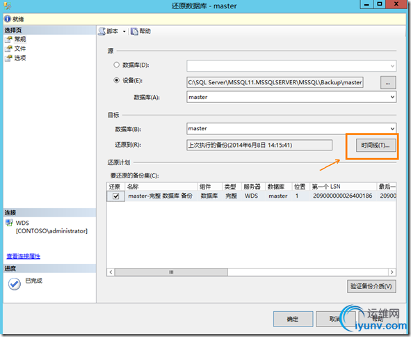

  (二)数据库恢复顾问(简化时间点还原)
  参考:
  Database Recovery Advisor feature of SQL Server 2012
  http://blogs.msdn.com/b/customer_reviews_of_stb_products/archive/2012/10/24/database-recovery-advisor-feature-of-sql-server-2012-by-basit-farooq.aspx

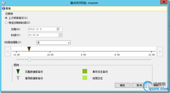

  点开上图的时间线,可以看到备份时间线,如图。
