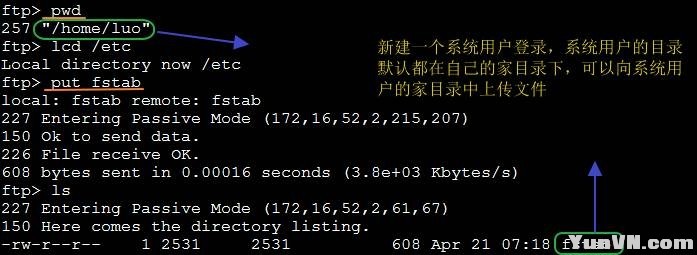

上传文件到系统用户的家目录下
  • ftp> lcd /etc
  • Local directory now /etc
  • ftp> put fstab
  • local: fstab remote: fstab
  • 227 Entering Passive Mode (172,16,52,2,41,90)
  • 150 Ok to send data.
  • 226 File receive OK.
  • 608 bytes sent in 0.0002 seconds (2.9e+03 Kbytes/s)
  • ftp> ls
  • 227 Entering Passive Mode (172,16,52,2,151,90)
  • 150 Here comes the directory listing.
  • -rw-r--r--    1 2531     2531          608 Apr 21 08:04 fstab

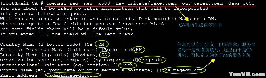

3.创建文件和目录
  • CA#mkdir newcerts certs crl
  • CA#touch index.txt
  • CA#echo 01 > serial

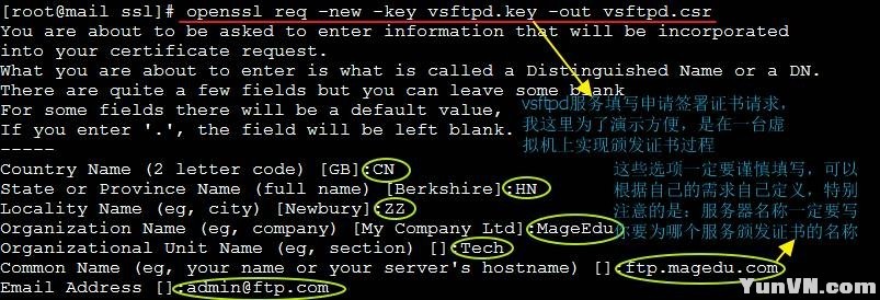

5.vsftpd签署申请证书请求,同时在配置文件/etc/pki/tls/openssl.cnf修改指定的目录
  • #vim /etc/pki/tls/openssl.cnf
  • dir             = /etc/pki/CA
