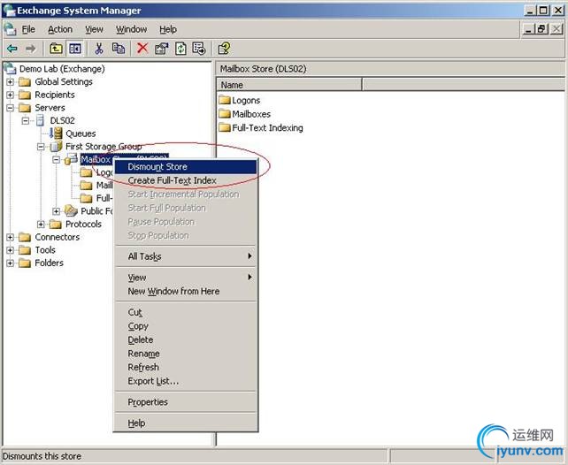

  Alright we’re ready to have the dial-tone database created, so if it’s not already the case you first need to dismount the Mailbox Store that are to be restored from backup. In order to do so open the Exchange System Manager and drill down to the Mailbox Store under the respective Storage Group. Now right-click the Mailbox Store and select Dismount Store as shown in Figure 1 below.
  Figure 1: Dismounting the corrupt Mailbox Store

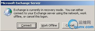

  Now that the dial-tone database has been created, the next time any user with an Outlook 2003 client configured with cached mode logs on, she will be>
  Figure 1: Outlook 2003 Exchange Recovery Mode
  Outlook 2003 Exchange Recovery Mode lets you choose between Connect and Work Offline, if you click Connect you’re connected with an empty Exchange Mailbox similar to the one shown in Figure 2, that means email messages, rules, signatures, etc are gone, but you’re able to search the Global Address List (GAL) as well as send and receive email messages just like was the case before.

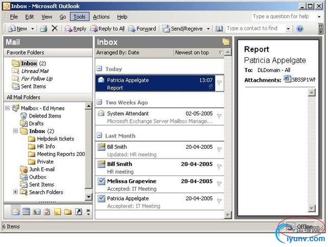

  Figure 2: Outlook 2003 in Online Mode accessing a Dial-tone database
  If you click Work Offline the OST file (which is stored locally on the client) is opened, from here you can access any email message which was synchronized between the Exchange mailbox and the OST file prior to the Mailbox Store crash as shown in Figure 3 below.

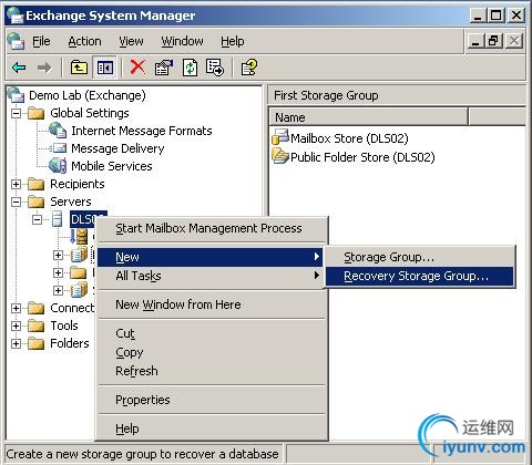

  Now is the time to restore our crashed Mailbox Store from backup, we’re going to restore it to a Recovery Storage Group, so before doing anything else we need to create this special Storage Group. This is done by opening the Exchange System Manager, here you drill down to and right-click the respective Exchange Server object located under the Servers container. In the context menu select New then Recovery Storage Group as shown in Figure 4 below.

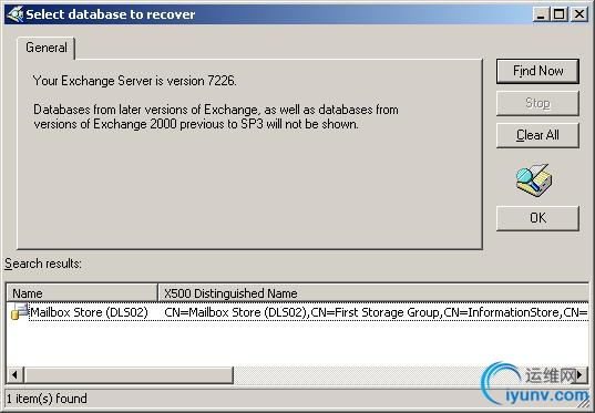

  Figure 4: Creating the Recovery Storage Group
  Specify the drive you want to restore the Mailbox Store to (see Figure 5). If disk space allows it, it’s a good>
  Figure 5: Specifying Log and System Path location

  Now that we have the Recovery Storage Group in place, we need to add the database (the one we want to restore from backup) to this Recovery Storage Group. This is done by right-clicking the Recovery Storage Group, then select Add database to recover, which brings us to the screen shown in Figure 6. Here you should highlight the Mailbox Store you want to restore, then click OK.
  Figure 6: Adding the database to the Recovery Storage Group

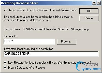

  Click Start Restore then specify the server to restore to and a temporary location for the log and patch files. Also remember to check mark Last Restore Set (Log file replay will start after this restore completes.) and Mount Database After Restore (see Figure 11), then click Next.
  Figure 11: Specifying the server, temporary location for log and patch files

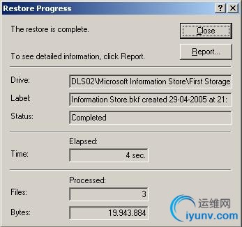

  The restore will now begin and depending on how large the Mailbox Store is this can take several minutes/hours. When the restore is complete simply click Close (see Figure 12) and exit NTBackup.
  Figure 12: Mailbox Store restore complete

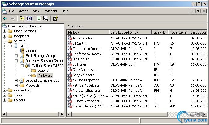

  It’s time to verify the restored Mailbox Store is visible under the Recovery Storage Group in the System Manager as well as check that the respective mailboxes are listed under the Mailboxes container object (see Figure 1).
  Figure 1: Restored Mailbox Store under the Recovery Storage Group as seen in System Manager

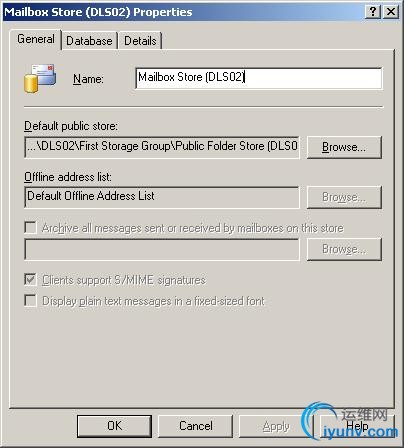

  Back in the System Manager you should open the Properties of each Mailbox Store, select the Database tab and check mark This database can be overwritten by a restore (shown in Figure 4 below).
  Figure 4: Database tab in the Properties of the Mailbox Store

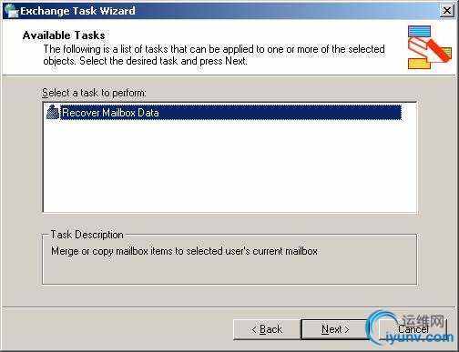

  To merge the Mailboxes from the dial-tone database to the original database restored from backup, drill down to the Recovery Storage Group > Mailbox Store > Mailboxes in the System Manager console. Here you should select the mailboxes that need to be merged, then right-click and select Exchange Tasks in the context menu as shown in Figure 5 below.
  Figure 5: Selecting the Mailboxes that need to be merged
  Now click Next twice (see Figure 6).

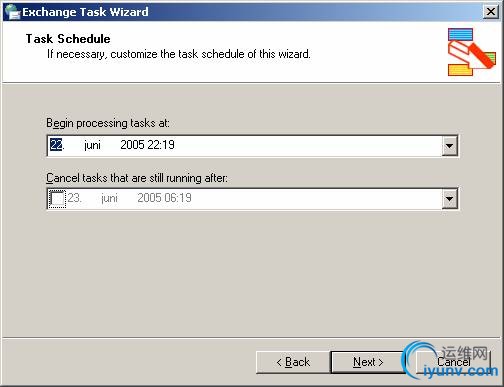

  Schedule the processing task or begin the merging immediately, then click Next (see Figure 9).
  Figure 9: Schedule the processing task

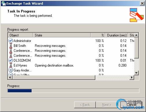

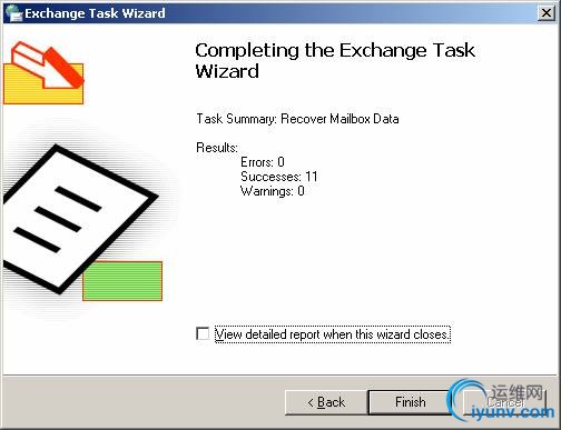

  Let the task finish then click Finish (Figure 10 and 11).
  Figure 10: Task In Progress
  Figure 11: Completing the Exchange Task Wizard
