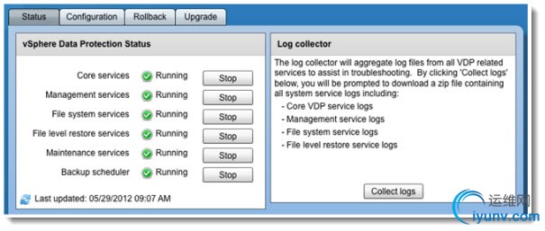

  Here is a screenshot what it looks like just after the deployment of the appliance. The “maintenance mode”.

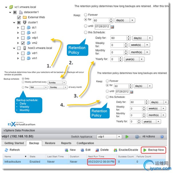

  Backup/restoration jobs and scheduling - those tasks are Wizard driven and permits the configuration of backup job. In the UI There are containers such as data centers, clusters, hosts, folders, etc. An individual VMs can be selected for backup. If new VMs are added to a container that is currently backed up (backup job has already been configured), these new VMs will automatically get backed up on the next run of the backup job.

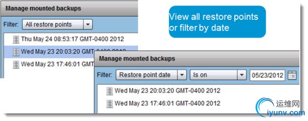

  8 mount points mounted simultaneously – another thing is that you can mount more than one restore point simultaneously (eight maximum), which can helpful if you are not sure of the exact version/date of the file you need to restore.

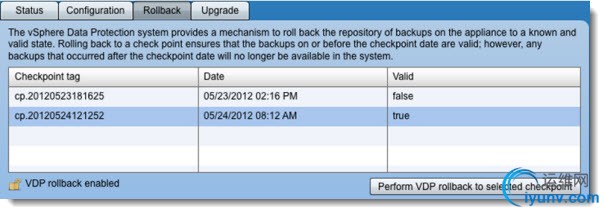

  VDP Rollback and Checkpoints – this feature that I mentioned at the beginning, helps you (if needed) to restore the appliance to the previous point in time (like in windows, the system restore application).
