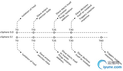

Isolation response and detection changes
  Another major change was part of the Isolation Response and Isolation Detection mechanism. Again from the outside it looks like not much has changed but actually a lot has and I will try to keep it simple and explain what has and why this is important to realize. First thing is the deprecation of “das.failuredetectiontime”. I know many of you used this advanced setting to tweak when the host would trigger the isolation response, that is no longer possible and needed to be honest. If you’ve closely read my other articles you hopefully picked up on the datastore heartbeating part already which is one reason for not needing this anymore. The other reason is that before the isolation response is triggered the host will actually validate if virtual machines can be restarted and if it isn’t an all out network outage. Most of us have been there at some point, a network admin decides to upgrade the switches and all hosts trigger the isolation response at the same time… well that won’t happen anymore! One thing that has changed because of that is the time it takes before a restart will be initiated.
  The isolation detection mechanism has changed substantially since previous versions of vSphere. The following timeline is the timeline for a vSphere 5.0 host:
  • T0 – Isolation of the host (slave)
  • T10s – Slave enters “election state”
  • T25s – Slave elects itself as master
  • T25s – Slave pings “isolation addresses”
  • T30s – Slave declares itself isolated and “triggers” isolation response
  For a vSphere 5.1 host this timeline slightly differs due the insertion of a minimum 30s delay after the host declares itself isolated before it applies the configured isolation response. This delay can be increased using the advanced option das.config.fdm.isolationPolicyDelaySec.
  • T60s – Slave “triggers” isolation response
  Or as Frank would say euuuh show:
  After the completion of this sequence, the (new) master will learn the host was isolated and will restart virtual machines based on the information provided by the slave.
