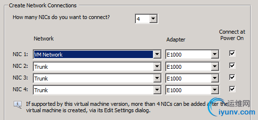

  • 4 NICs — connect NIC 1 to the management network and the rest to the “Trunk” network: DSC0000.png

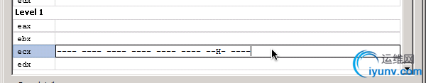

  • Add hypervisor.cpuid.v0 = FALSE to the VM configuration
  • Add —-:—-:—-:—-:—-:—-:–h-:—- to the CPU mask for Level 1 ECX (Intel)
