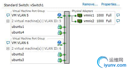

  First, we’ll want to have a quick look at the host’s network configuration from the vSphere Client. As you can see below, we have four virtual machines spread across two VLANs – half of them in VLAN 5 and the other half in VLAN 6. Two gigabit network adapters are being used as uplinks in this vSwitch.
DSC0001.png Based on this simple vSwitch depiction, we can draw several conclusions that may come in handy during our troubleshooting. First, we can see that VLAN IDs are specified for the two port groups. This indicates that we are doing VST or Virtual Switch Tagging. For this to work correctly, vmnic1 and vmnic2 in the network team must be configured for VLAN trunking using the 802.1q protocol on the physical switch. We’ll keep this information in the back of our heads for now and move on.

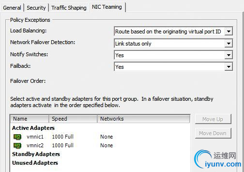

  Next, since we have a pair of network adapters in the team, we need to determine the load balancing type employed (this could change the troubleshooting approach quite a bit, so you’ll want to know this right up front). As seen below, we were able to determine that the default load balancing method – Route based on the originating virtual port ID – is being used based on the vSwitch properties.
DSC0002.png With this, we know several things about the way the network should be configured.
From a virtual switch perspective, we know that we’ll have a spread of virtual machines across both network adapters as both of the uplinks are in an Active state. We’ll have a one-to-one mapping of virtual machine network adapters to physical adapters. Assuming each virtual machine has only a single virtual network card, each virtual machine will be bound to a single physical adapter on the ESXi host. In theory, we should have a rough 50/50 split of virtual machines across both physical adapters in the team. It may not be a perfect 50/50 split across all VMs, but any single VM on this vSwitch has an equal chance of being on vmnic1 or vmnic2.
  From the physical switch, each of these vmnics should be connecting to independent and identically configured 802.1q VLAN trunk ports – this is important. With the default ‘Route based on originating virtual port ID’ load balancing type, the physical switch should not be configured for link aggregation (802.3ad, also known as etherchannel in the Cisco world, or Trunks in the HP world). Link aggregation or bonding should be used only with IP hash load balancing type.
  With this small amount of information, we are able to determine quite a bit about the way the environment should be configured in both ESXi and on the physical switch, and how the load balancing should be behaving.

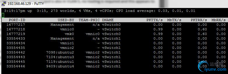

  When thinking about this problem from an end-to-end perspective, the next logical place to look would be the physical network adapters. We know that we have two adapters in a NIC team, but which NIC is ubuntu1 actually using? Which NIC is ubuntu4 using? To determine this, we’ll need to connect to the host using SSH or via the Local Tech Support Mode console and use a tool called esxtop. From within esxtop, we simply hit ‘n’ for the networking view and immediately obtain some very interesting information:
DSC0003.png As you can see above, this view tells us exactly which physical network adapter each virtual machine is currently bound to. There is a very clear pattern that we can see almost immediately – ubuntu1 is the only virtual machine currently utilizing vmnic1. It is unlikely that this is a mere coincidence, but most vSphere administrators may not be able to approach their network teams without more information.

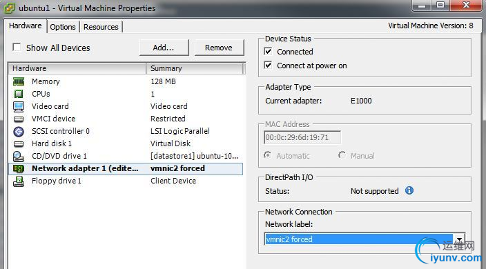

  Assuming there really is a problem with vmnic1 or its associated physical switch port, we would expect the VM to regain connectivity if we forced it to use vmnic2 instead. Let’s confirm this theory.

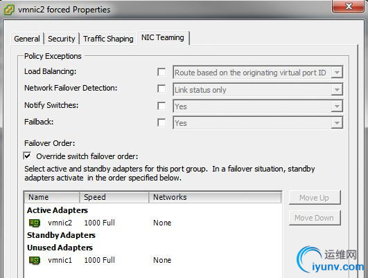

  The easiest way to accomplish this would be to create a temporary port group identical to VM VLAN 5, but configured to use only vmnic2. That way when we put ubuntu1’s virtual NIC into that port group, it will have no choice but to use vmnic2. In our example, I created a new port group called ‘vmnic2 forced’:
DSC0004.png After creating this new temporary port group, you simply need to check the ‘Override switch failover order’ checkbox in the NIC Teaming tab and ensure that only the desired adapter is listed as Active. All other adapters should be moved down to Unused. In our case, vmnic2 is now the only active adapter associated with this port group called ‘vmnic2 forced’. We can now edit the settings of ubuntu1 and configure its virtual network card to connect to this new port group:

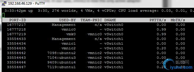

DSC0005.png Immediately after making this change – even if the VM is up and running – we should see esxtop reflect the new configuration:
As you can see above, ubuntu1 is now forced on vmnic2, consistent with the other VMs that are not having a problem.
