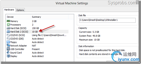

  2) Attach a new hard disk VMDK file (single file, no split) size of 10GB. The virtual machine should be powered off to add new virtual hard disk.

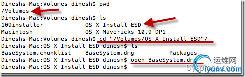

  Run following command from inside newly mounted volume called ‘OS X Install ESD’.
  Wait for some time to get over of mounting BaseSystem.

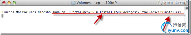

  8.) Let’s copy the packages from original location to new installer disk.
  Make sure to follow correct volume names in your scenario.

  12) Attach the bootable VMDK file which we created in earlier steps. Make sure to add it as first disk of SCSI controller of virtual machine.

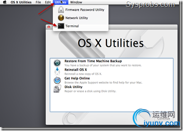

  As you could see in above screen, there is no install button to start installation straightaway. No worries, start the terminal as mentioned.
