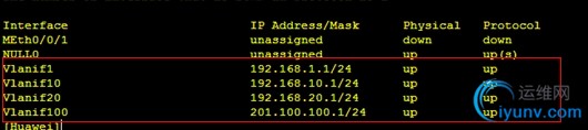

  l 给vlan110 20 100配ip地址
  [Huawei-GigabitEthernet0/0/3]intvlan 1
  [Huawei-Vlanif1]ipadd 192.168.1.1 24
  [Huawei-Vlanif1]
  [Huawei]intvlan 10
  [Huawei-Vlanif10]
  [Huawei-Vlanif10]ip add192.168.10.1 24
  [Huawei-Vlanif10]
  [Huawei-Vlanif10]int vlan20
  [Huawei-Vlanif20]ip add192.168.20.1 24
  [Huawei-Vlanif20]
  [Huawei-Vlanif20]int vlan100
  [Huawei-Vlanif100]ip add201.100.100.1 24
  l  为交换机配默认路由
  [Huawei]iproute-s
  [Huawei]ip route-static 0.0.0.0 0.0.0.0 201.100.100.2
  结果如图:
