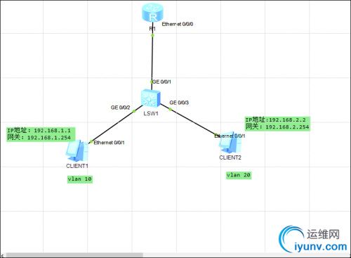

  实验要求:不同的2个VLAN之间能够通信
  过程如下:
  [SW1]vlan 10
  [SW1-vlan10]q
  [SW1-vlan20]
  [SW1-vlan20]q
  [SW1]
  [SW1]int g0/0/2
  [SW1-GigabitEthernet0/0/2]port link-type access (端口的链路类型)
  [SW1-GigabitEthernet0/0/2]port default vlan 10(把这个接口划分到vlan 10)
  [SW1-GigabitEthernet0/0/2]q
  [SW1]int g0/0/3
  [SW1-GigabitEthernet0/0/3]port link-type access
  [SW1-GigabitEthernet0/0/3]port default vlan 20
  [SW1-GigabitEthernet0/0/3]q
  [SW1]int g0/0/1
  [SW1-GigabitEthernet0/0/1]port link-type trunk(接口链路类型改为trunk)
  [SW1-GigabitEthernet0/0/1]port trunk allow-pass vlan 10 20(该TRUNK链路放行所有VLAN 10 和20的数据)
  在R1的路由器上需要配置2个子接口,分别对应PC端的VLAN 10和VLAN 20
  [R1]int e0/0/0.10
  [R1-Ethernet0/0/0.10]
  [R1-Ethernet0/0/0.10]control-vid 10 dot1q-termination (识别PC端发出来的数据
  在这个借口下使能802.1Q协议给VID10,在更高级的路由器上,这条命令就可以不写了)
  [R1-Ethernet0/0/0.10]dot1q termination vid 10(打上标签,把802.1q协议封装给vlan 10)
  [R1-Ethernet0/0/0.10]arp broadcast en (去找目标端的PC,开启ARP)
  [R1-Ethernet0/0/0.10]ip address 192.168.1.254 24(配置网关)
  [R1-Ethernet0/0/0.10]q
  [R1]
  [R1]int e0/0/0.20
  [R1-Ethernet0/0/0.20]control-vid 20 dot1q-termination
  [R1-Ethernet0/0/0.20]dot1q termination vid 20
  [R1-Ethernet0/0/0.20]arp broadcast en
  [R1-Ethernet0/0/0.20]ip address 192.168.2.254 24
  到此结束!不同的VLAN之间下能够通信,目的完成!
