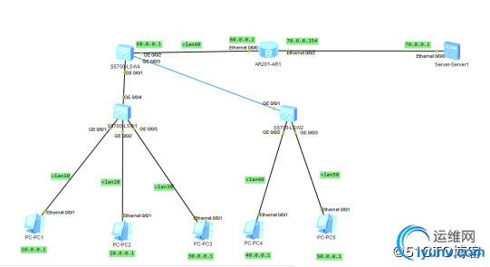

  如图可以使PC1、PC2、PC3、PC4、PC5、server1、之间可以互相ping通:
  实验步骤:
  1.配置PC1/PC2/PC3/PC4/PC5的IP,子网掩码,网关如图:

  2.配置Switch1如下:
  <Huawei>undo terminal monitor
  Info: Current terminal monitor is off.
  <Huawei>system-view
  Enter system view, return user view with Ctrl+Z.
  [Huawei]sysname SW1
  [SW1]vlan 10
  [SW1-vlan10]vlan 20
  [SW1-vlan20]vlan 30
  [SW1-vlan30]q
  [SW1-GigabitEthernet0/0/1]port link-type access
  [SW1-GigabitEthernet0/0/1]port default vlan 10
  [SW1-GigabitEthernet0/0/1]undo shut
  [SW1-GigabitEthernet0/0/1]undo shutdown
  Info: Interface GigabitEthernet0/0/1 is not shutdown.
  [SW1-GigabitEthernet0/0/1]q
  [SW1]interface g0/0/2
  [SW1-GigabitEthernet0/0/2]port link-type access
  [SW1-GigabitEthernet0/0/2]port default vlan 20
  [SW1-GigabitEthernet0/0/2]undo shut
  Info: Interface GigabitEthernet0/0/2 is not shutdown.
  [SW1-GigabitEthernet0/0/2]q
  [SW1]interface g0/0/3
  [SW1-GigabitEthernet0/0/3]port link-type ac
  [SW1-GigabitEthernet0/0/3]port link-type access
  [SW1-GigabitEthernet0/0/3]port default vlan 30
  [SW1-GigabitEthernet0/0/3]undo shut
  Info: Interface GigabitEthernet0/0/3 is not shutdown.
  [SW1]interface g0/0/4
  [SW1-GigabitEthernet0/0/4]port link-type trunk
  [SW1-GigabitEthernet0/0/4]port trunk allow-pass vlan  all
  [SW1-GigabitEthernet0/0/4]undo shutdown
  Info: Interface GigabitEthernet0/0/4 is not shutdown.
  3.配置Switch2如下:
  <Huawei>system-view
  [Huawei]sysname SW2
  [SW2]vlan 40
  [SW2-vlan40]vlan 50
  [SW2-vlan50]q
  [SW2]interface g0/0/2
  [SW2-GigabitEthernet0/0/2]port link-type access
  [SW2-GigabitEthernet0/0/2]port default vlan 40
  [SW2-GigabitEthernet0/0/2]undo shutdown
  [SW2-GigabitEthernet0/0/2]q
  [SW2]interface g0/0/3
  [SW2-GigabitEthernet0/0/3]port link-type access
  [SW2-GigabitEthernet0/0/3]port default vlan 50
  [SW2-GigabitEthernet0/0/3]undo shutdown
  [SW2-GigabitEthernet0/0/3]q
  [SW2]interface g0/0/1
  [SW2-GigabitEthernet0/0/1]port link-type trunk
  [SW2-GigabitEthernet0/0/1]undo shutdown
  [SW2-GigabitEthernet0/0/1]port trunk allow-pass vlan  all
  4.配置Switch3如下:
  <Huawei>system-view
  [Huawei]sysname SW3
  [SW3]vlan 10
  [SW3-vlan10]vlan 20
  [SW3-vlan20]vlan 30
  [SW3-vlan30]vlan 40
  [SW3-vlan40]vlan 50
  [SW3-vlan50]q
  [SW3]interface vlan 10
  [SW3-Vlanif10]ip address 10.0.0.254 255.0.0.0
  [SW3-Vlanif10]undo shutdown
  Info: Interface Vlanif10 is not shutdown.
  [SW3-Vlanif10]q
  [SW3]interface vlan 20
  [SW3-Vlanif20]ip address 20.0.0.254 255.0.0.0
  [SW3-Vlanif20]undo shutdown
  Info: Interface Vlanif20 is not shutdown.
  [SW3-Vlanif20]q
  [SW3]interface vlan 30
  [SW3-Vlanif30]ip address 30.0.0.254 255.0.0.0
  [SW3-Vlanif30]undo shutdown
  Info: Interface Vlanif30 is not shutdown.
  [SW3-Vlanif30]q
  [SW3]interface vlan 40
  [SW3-Vlanif40]ip address 40.0.0.254 255.0.0.0
  [SW3-Vlanif40]undo shutdown
  Info: Interface Vlanif40 is not shutdown.
  [SW3-Vlanif40]q
  [SW3]interface vlan 50
  [SW3-Vlanif50]ip address 50.0.0.254 255.0.0.0
  [SW3-Vlanif50]undo shutdown
  Info: Interface Vlanif50 is not shutdown.
  [SW3-Vlanif50]q
  [SW3]interface g0/0/1
  [SW3-GigabitEthernet0/0/1]port link-type trunk
  [SW3-GigabitEthernet0/0/1]port trunk allow-pass vlan all
  [SW3-GigabitEthernet0/0/1]undo shutdown
  [SW3-GigabitEthernet0/0/1]q
  [SW3]interface g0/0/2
  [SW3-GigabitEthernet0/0/2]port link-type trunk
  [SW3-GigabitEthernet0/0/2]undo shutdown
  [SW3-GigabitEthernet0/0/2]port trunk allow-pass vlan all
  [SW3]vlan 60
  [SW3-vlan60]q
  [SW3]interface g0/0/3
  [SW3-GigabitEthernet0/0/3]port link-type access
  [SW3-GigabitEthernet0/0/3]port default vlan 60
  [SW3-GigabitEthernet0/0/3]undo shutdown
  [SW3]interface vlan 60
  [SW3-Vlanif60]ip address 60.0.0.1 255.0.0.0
  5.配置R1如下
  <Huawei>system-view
  [Huawei]sysname R1
  [R1-GigabitEthernet0/0/0]ip address 60.0.0.2 255.0.0.0
  [R1-GigabitEthernet0/0/0]undo shut
  Info: Interface GigabitEthernet0/0/0 is not shutdown.
  [R1-GigabitEthernet0/0/0]q
  [R1]interface g0/0/1
  [R1-GigabitEthernet0/0/1]ip address 70.0.0.254 255.0.0.0
  [R1-GigabitEthernet0/0/1]undo shut
  6.配置server1如图:
  7.在R1配置默认路由:
  8.在SW3上配置静态路由:
  结果验证如图:
