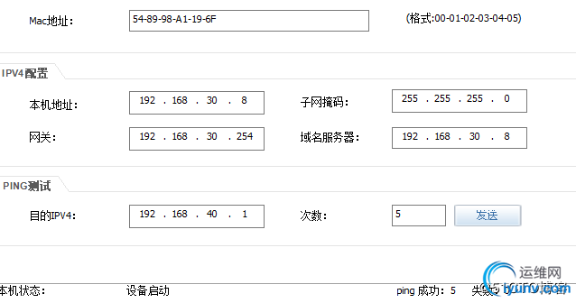

  四,sw9配置(sw9.10trunk)
  [sw9]vlan batch 30 40 50
  Info: This operation may take a   few seconds. Please wait for a moment...done.
  [sw9]int vlan 30
  [sw9-Vlanif30]undo shutdown
  Info: Interface Vlanif30 is not   shutdown.
  [sw9-Vlanif30]ip add   192.168.30.254 24
  [sw9-Vlanif30]q
  [sw9]int vlan 50
  [sw9-Vlanif50]ip add 192.168.50.2   24
  [sw9-Vlanif50]q
  [sw9]int vlan 40
  [sw9-Vlanif40]undo shutdown
  [sw9-Vlanif40]ip add 192.168.40.254 24
  [sw9-Vlanif40]q
  [sw9]int g0/0/1
  [sw9-GigabitEthernet0/0/1]undo shutdown
  [sw9-GigabitEthernet0/0/1]port link-type trunk
  [sw9-port-group-trunk]port trunk allow-pass vlan all
  [sw9-port-group-trunk]q
  [sw9]int g0/0/2
  [sw9-GigabitEthernet0/0/2]port link-type trunk
  [sw9-GigabitEthernet0/0/2]port trunk allow-pass vlan all
  [sw9-GigabitEthernet0/0/2]undo   shutdown
  [sw9-GigabitEthernet0/0/2]q
  [sw9]rip
  [sw9-rip-1]version 2
  [sw9-rip-1]network 192.168.30.0
  [sw9-rip-1]network 192.168.40.0
  [sw9-rip-1]network 192.168.50.0

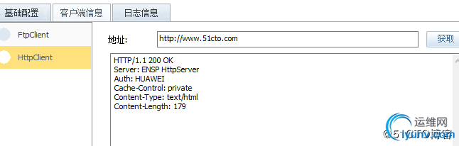

  六.全网互通
