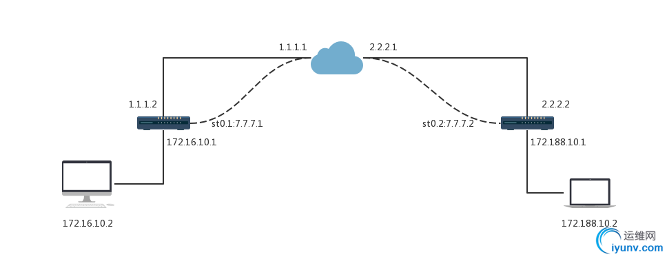

  1.实验拓扑:
  2.实验过程:
  拓扑很简单,分别用两台srx340模拟local和remote,先进行正常的***配置:

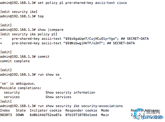

  第一步,修改域分享密码,把原先的Juniper换成Cisco,发现隧道down掉了:
  我们开始查看debub文件,搜索关键字设置为error:
  [Feb  1 10:14:24]<none>:500 (Responder) <-> 2.2.2.2:500 { 8bf32842 80c83c52 - c534184e 9f9eb944 [0] / 0x6a1843f7 } Info; Notification data has attribute list
  [Feb  1 10:14:24]<none>:500 (Responder) <-> 2.2.2.2:500 { 8bf32842 80c83c52 - c534184e 9f9eb944 [0] / 0x6a1843f7 } Info; Notify message version = 1
  [Feb  1 10:14:24]<none>:500 (Responder) <-> 2.2.2.2:500 { 8bf32842 80c83c52 - c534184e 9f9eb944 [0] / 0x6a1843f7 } Info; Offending payload type = 159
  [Feb  1 10:14:24]<none>:500 (Responder) <-> 2.2.2.2:500 { 8bf32842 80c83c52 - c534184e 9f9eb944 [0] / 0x6a1843f7 } Info; Offending payload data offset = 0
  [Feb  1 10:14:24]<none>:500 (Responder) <-> 2.2.2.2:500 { 8bf32842 80c83c52 - c534184e 9f9eb944 [0] / 0x6a1843f7 } Info; Error text = Incorrect pre-shared key (Invalid next payload value)
  [Feb  1 10:14:24]<none>:500 (Responder) <-> 2.2.2.2:500 { 8bf32842 80c83c52 - c534184e 9f9eb944 [0] / 0x6a1843f7 } Info; Offending message>  [Feb  1 10:14:24]<none>:500 (Responder) <-> 2.2.2.2:500 { 8bf32842 80c83c52 - c534184e 9f9eb944 [0] / 0x6a1843f7 } Info; Received notify err = Invalid payload type (1) to isakmp sa, delete it
  红色的字体很清晰的显示:不正确的域分享密码。

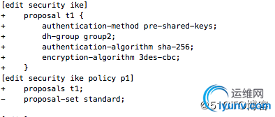

  第二步,继续搞破坏,之前的实验为了偷懒,我都是用的预设的加密和认证。现在使用自定义的proposals,我在两段的authentication-algorithm做个小手脚:
  然后***自然就down掉了:
  继续看debug文件(***排错对于菜鸟真是头疼,现在做实验知道了结果反推回去真是神清气爽啊):
  仍然搜索关键字error:
  [Feb  1 10:31:34]ike_st_i_private: Start
  [Feb  1 10:31:34]ike_send_notify: Connected, SA = { b5683f91 580f05d7 - 3780e055 cd8cc990}, nego = 0
  [Feb  1 10:31:34]1.1.1.2:500 (Initiator) <-> 2.2.2.2:500 { b5683f91 580f05d7 - 3780e055 cd8cc990 [-1] / 0x00000000 } IP; Connection got error = 14, calling callback
  [Feb  1 10:31:34]ikev2_fb_v1_encr_id_to_v2_id: Unknown IKE encryption>
  [Feb  1 10:31:34]ikev2_fb_v1_hash_id_to_v2_prf_id: Unknown IKE hash alg>
  [Feb  1 10:31:34]ikev2_fb_v1_hash_id_to_v2_integ_id: Unknown IKE hash alg>  [Feb  1 10:31:34]IKE negotiation fail for local:1.1.1.2, remote:2.2.2.2 IKEv1 with status: No proposal chosen
  [Feb  1 10:31:34]  IKEv1 Error : No proposal chosen
  [Feb  1 10:31:34]IPSec Rekey for SPI 0x0 failed
  [Feb  1 10:31:34]IPSec SA done callback called for sa-cfg P1 local:1.1.1.2, remote:2.2.2.2 IKEv1 with status No proposal chosen
  出现了多个error,failed。我们可以断定是在IKEV1阶段出现了问题,缩小了排错的范围(修改:IKE V1的意思是使用的IKE 版本1 ,不是阶段1,现在已经有了IKE V2,可以更快的协商并且防止dos***,从而提供安全性)。
