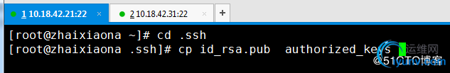

  vim /.ssh/authorized_keys

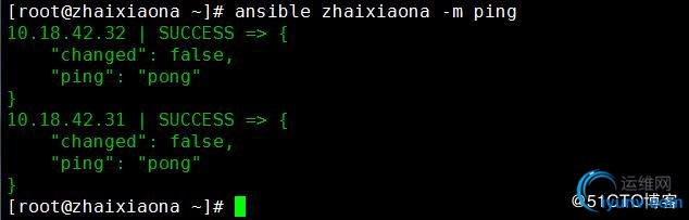

  一:测试目标主机是否在线:ping模块
  主机如果在线,则回复pong
  测试主机是否在线
  [root@zhaixiaona ~]# ansible zhaixiaona -m ping
  10.18.42.32 | SUCCESS => {
  "changed": false,
  "ping": "pong"
  10.18.42.31 | SUCCESS => {
  "changed": false,
  "ping": "pong"
