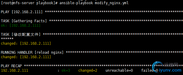

修改nginx.conf测试:
[root@nfs-server playbook]# cat modify_nginx.yml
- hosts: 192.168.2.111
  tasks:
  - name: "修改配置文件"
    lineinfile:
      dest: "/etc/nginx/conf.d/default.conf"
      regexp: 'listen       80;'
      line: '    listen       8000;'
      #backup: yes
      backrefs: yes
    notify:
      - reload nginx
  handlers:
    - name: reload nginx
      service: name=nginx state=reloaded
  注:经测试,当不添加backerfs: yes参数时,匹配到后也会进行替换,但当匹配到的内容不存在时,会在最后增加一行;所以当不增加backerfs参数时,要确定匹配到的内容存在;
