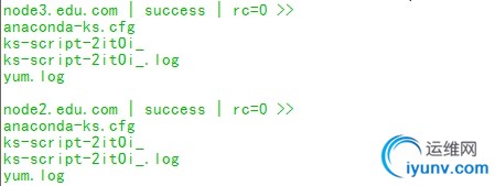

  例:把根目录下的anaconda-ks.cfg文件复制到定义为dbservers的两台主机上:
  [root@control ~]# ansible dbservers -m copy -a "src=/root/anaconda-ks.cfg dest=/tmp/"
  node3.edu.com | success >> {
  node2.edu.com | success >> {
  查看一下有没有复制过去
  [root@control ~]# ansible dbservers -a "ls /tmp/"

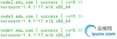

  例:所有的主机都安装上corosync.
  [root@control ~]# ansible all -m yum -a "state=present name=corosync"
  查看一下是否安装上了
  [root@control ~]# ansible all -a "rpm -q corosync"

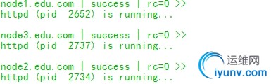

  例:设置web服务开机自动启动
  [root@control ~]# ansible all -m service -a "state=started name=httpd enabled=yes"
  查看一下是否启动了
  [root@control ~]# ansible all -a "service httpd status"
