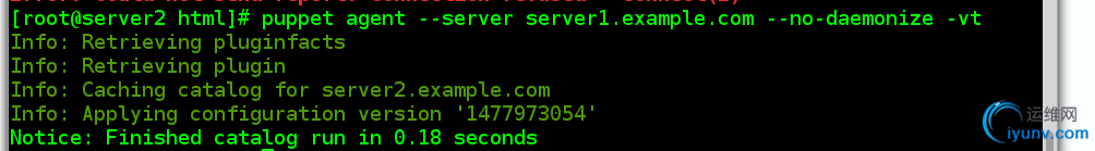

  # puppet agent --server server1.example.com --no-daemonize -vt//同步数据

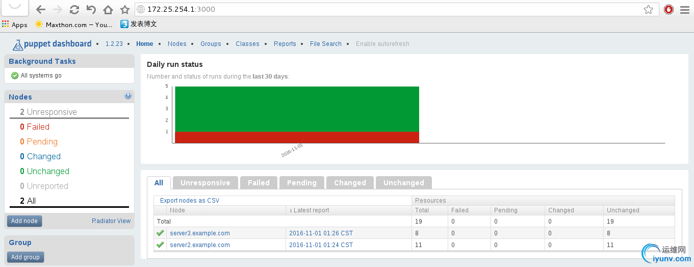

  9) 浏览器访问 172.25.254.1:3000

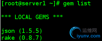

  1)[root@server1 mnt]# gem list
  *** LOCAL GEMS ***
  json (1.5.5)
  rack (1.6.4)
  2)不够就下载

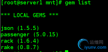

  # gem install passenger-5.0.15.gem rack-1.6.4.gem

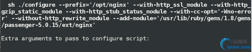

  4) #passenger-install-nginx-module
  //脚本会自动安装 nginx 支持,按提示操作,其它按Enter就好,编译过程比较慢

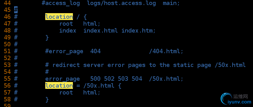

  # vim nginx.conf
  server {
  listen       8140;
  server_name  server1.example.com;
  root    /etc/puppet/rack/public;
  passenger_enabled on;
  passenger_set_header X_CLIENT_DN $ssl_client_s_dn;
  passenger_set_header X_CLIENT_VERIFY $ssl_client_verify;
  ssl on;
  ssl_session_timeout 5m;
  ssl_certificate /var/lib/puppet/ssl/certs/server1.example.com.pem;
  ssl_certificate_key /var/lib/puppet/ssl/private_keys/server1.example.com.pem;
  ssl_client_certificate /var/lib/puppet/ssl/ca/ca_crt.pem;
  ssl_crl /var/lib/puppet/ssl/ca/ca_crl.pem;
  ssl_verify_client optional;
  ssl_ciphers SSLv2:-LOW:-EXPORT:RC4+RSA;
  ssl_prefer_server_ciphers on;
  ssl_verify_depth 1;
  ssl_session_cache shared:SSL:128m;
  # /opt/nginx/sbin/nginx -t //检测 nginx配置文件是否有错
