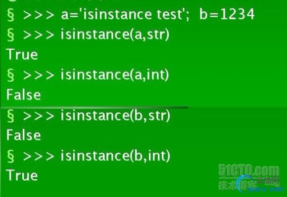

  5 isinstance(num,type) 测试对象类型
  自定义一个函数:
  def displaynum(num):
  print num ,&quot;is&quot;
  if isinstance(num,(int,float,long,complex)):
  print &quot;a number type:&quot;, type(num).__name__
  else:
  print num,&quot;s not number&quot;

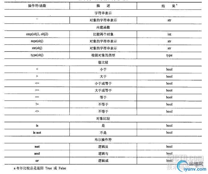

  六。操作符和内建函数总结一个表
