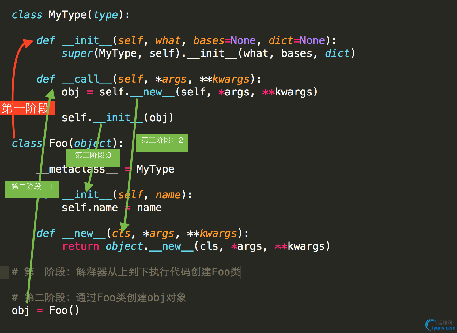

class MyType(type):  def __init__(self,*args,**kwargs):
  print("Mytype __init__",*args,**kwargs)
  def __call__(self, *args, **kwargs):
  print("Mytype __call__", *args, **kwargs)
  obj = self.__new__(self)
  print("obj ",obj,*args, **kwargs)
  print(self)
  self.__init__(obj,*args, **kwargs)
  return obj
  def __new__(cls, *args, **kwargs):
  print("Mytype __new__",*args,**kwargs)
  return type.__new__(cls, *args, **kwargs)
# print('here...')
class Foo(object):
  #__metaclass__ = MyType
  def __init__(self,name):
  self.name = name
  print("Foo __init__")
  def __new__(cls, *args, **kwargs):  #__new__和__init__一样,是类自带的方法,不过__new__会比__init__先执行
  print("Foo __new__",cls, *args, **kwargs)
  #return object.__new__(cls)
f = Foo("Alex")
# print("f",f)
# print("fname",f.name)
执行结果:
Foo __new__ <class '__main__.Foo'> Alex #可以看到__new__比__init__先执行了。
Foo __init__
  print(self)
  return obj
# print('here...')
class Foo(object):
  self.name = name
  # return object.__new__(cls)    #注释掉
f = Foo("Alex") #这里已经创建了实例,只不过会被__new__重构
# print("f",f)
执行结果:
#可以看到只执行了__new__方法,而__init__没有执行,这是因为通过__new__来实例化,在调用了__init__
这个__new__是默认存在的,在这里写相当于重构了,一般没有去重构__new__的,这里改写只不过是为了了解__new__的存在和作用。
  print(self)
  return obj
  return type.__new__(cls, *args, **kwargs)   #去继承父类的__new__方法
# print('here...')
class Foo(object):
  # __metaclass__ = MyType
  self.name = name
f = Foo("Alex")
  metaclass 详解文章:http://stackoverflow.com/questions/100003/what-is-a-metaclass-in-python 得票最高那个答案写的非常好
