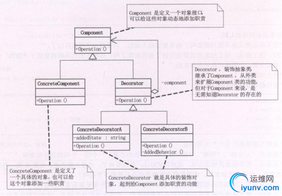

  三、装饰模式
  模式特点:动态地为对象增加额外的职责
  程序实例:展示一个人一件一件穿衣服的过程。
  代码特点:无
class Person:    def __init__(self,tname):
        self.name = tname    def Show(self):       print "dressed %s" %(self.name)class Finery(Person):
    componet = None    def __init__(self):        pass
    def Decorate(self,ct):
        self.componet = ct    def Show(self):    if(self.componet!=None):
        self.componet.Show()class TShirts(Finery):    def __init__(self):        pass
    def Show(self):        print "Big T-shirt "
        self.componet.Show()class BigTrouser(Finery):    def __init__(self):        pass
    def Show(self):        print "Big Trouser "
        self.componet.Show()if __name__ == "__main__":
    p = Person("somebody")
    bt = BigTrouser()
    ts = TShirts()
    bt.Decorate(p)
    ts.Decorate(bt)
    ts.Show()

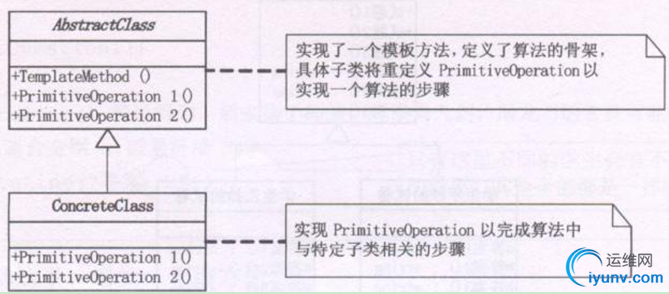

  七、模板方法模式
  模式特点:定义一个操作中的算法骨架,将一些步骤延迟至子类中。
  程序实例:考试时使用同一种考卷(父类),不同学生上交自己填写的试卷(子类方法的实现)
  代码特点:无
class TestPaper:    def TestQuestion1(self):        print "Test1:A. B. C. D."
        print "(%s)" %self.Answer1()    def TestQuestion2(self):        print "Test1:A. B. C. D."
        print "(%s)" %self.Answer2()    def Answer1(self):        return ""
    def Answer2(self):        return ""class TestPaperA(TestPaper):    def Answer1(self):        return "B"
    def Answer2(self):        return "C";class TestPaperB(TestPaper):    def Answer1(self):        return "D"
    def Answer2(self):        return "D";if __name__ == "__main__":
    s1 = TestPaperA()
    s2 = TestPaperB()    print "student 1"
    s1.TestQuestion1()
    s1.TestQuestion2()    print "student 2"
    s2.TestQuestion1()
    s2.TestQuestion2()

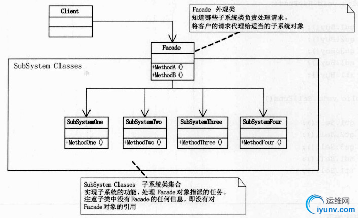

  八、外观模式
  模式特点:为一组调用提供一致的接口。
  程序实例:接口将几种调用分别组合成为两组,用户通过接口调用其中的一组。
  代码特点:无
class SubSystemOne:    def MethodOne(self):        print "SubSysOne"class SubSystemTwo:    def MethodTwo(self):        print "SubSysTwo"class SubSystemThree:    def MethodThree(self):        print "SubSysThree"class SubSystemFour:    def MethodFour(self):        print "SubSysFour"class Facade:    def __init__(self):
        self.one = SubSystemOne()
        self.two = SubSystemTwo()
        self.three = SubSystemThree()
        self.four = SubSystemFour()    def MethodA(self):        print "MethodA"
        self.one.MethodOne()
        self.two.MethodTwo()
        self.four.MethodFour()    def MethodB(self):        print "MethodB"
        self.three.MethodThree()if __name__ == "__main__":
    facade = Facade()
    facade.MethodA()
    facade.MethodB()

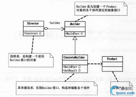

  九、建造者模式
  模式特点:将一个复杂对象的构建(Director)与它的表示(Builder)分离,使得同样的构建过程可以创建不同的表示(ConcreteBuilder)。
  程序实例:“画”出一个四肢健全(头身手腿)的小人
  代码特点:无
class Person:    def CreateHead(self):        pass
    def CreateHand(self):        pass
    def CreateBody(self):        pass
    def CreateFoot(self):        passclass ThinPerson(Person):    def CreateHead(self):        print "thin head"
    def CreateHand(self):        print "thin hand"
    def CreateBody(self):        print "thin body"
    def CreateFoot(self):        print "thin foot"class ThickPerson(Person):    def CreateHead(self):        print "thick head"
    def CreateHand(self):        print "thick hand"
    def CreateBody(self):        print "thick body"
    def CreateFoot(self):        print "thick foot"class Director:    def __init__(self,temp):
        self.p = temp    def Create(self):
        self.p.CreateHead()
        self.p.CreateBody()
        self.p.CreateHand()
        self.p.CreateFoot()if __name__ == "__main__":
    p = ThickPerson()
    d = Director(p)
    d.Create()

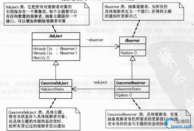

  十、观察者模式
  模式特点:定义了一种一对多的关系,让多个观察对象同时监听一个主题对象,当主题对象状态发生变化时会通知所有观察者。
  程序实例:公司里有两种上班时趁老板不在时偷懒的员工:看NBA的和看股票行情的,并且事先让老板秘书当老板出现时通知他们继续做手头上的工作。
  程序特点:无
class Observer:    def __init__(self,strname,strsub):
        self.name = strname
        self.sub = strsub    def Update(self):        passclass StockObserver(Observer):    #no need to rewrite __init__()
    def Update(self):        print "%s:%s,stop watching Stock and go on work!" %(self.name,self.sub.action)class NBAObserver(Observer):    def Update(self):        print "%s:%s,stop watching NBA and go on work!" %(self.name,self.sub.action)class SecretaryBase:    def __init__(self):
        self.observers = []    def Attach(self,new_observer):        pass
    def Notify(self):        passclass Secretary(SecretaryBase):    def Attach(self,new_observer):
        self.observers.append(new_observer)    def Notify(self):        for p in self.observers:
            p.Update()if __name__ == "__main__":
    p = Secretary()
    s1 = StockObserver("xh",p)
    s2 = NBAObserver("wyt",p)
    p.Attach(s1);
    p.Attach(s2);
    p.action = "WARNING:BOSS ";
    p.Notify()

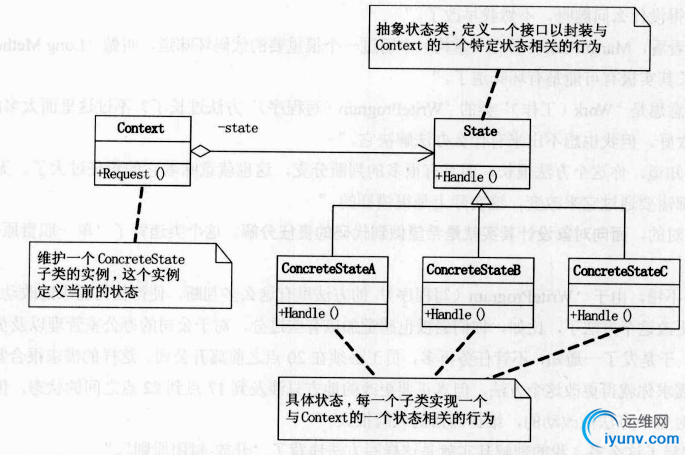

  十二、状态模式
  模式特点:当一个对象的内在状态改变时允许改变其行为,这个对象看起来像是改变了其类。
  程序实例:描述一个程序员的工作状态,当需要改变状态时发生改变,不同状态下的方法实现不同
  代码特点:无
class State:    def WirteProgram(self):        passclass Work:    def __init__(self):
        self.hour = 9
        self.current = ForenoonState()    def SetState(self,temp):
        self.current = temp    def WriteProgram(self):
        self.current.WriteProgram(self)class NoonState(State):    def WriteProgram(self,w):        print "noon working"
        if (w.hour<13):            print "fun."
        else:            print "need to rest."class ForenoonState(State):    def WriteProgram(self,w):        if (w.hour<12):            print "morning working"
            print "energetic"
        else:
            w.SetState(NoonState())
            w.WriteProgram()if __name__ == "__main__":
    mywork = Work()
    mywork.hour = 9
    mywork.WriteProgram()
    mywork.hour =14
