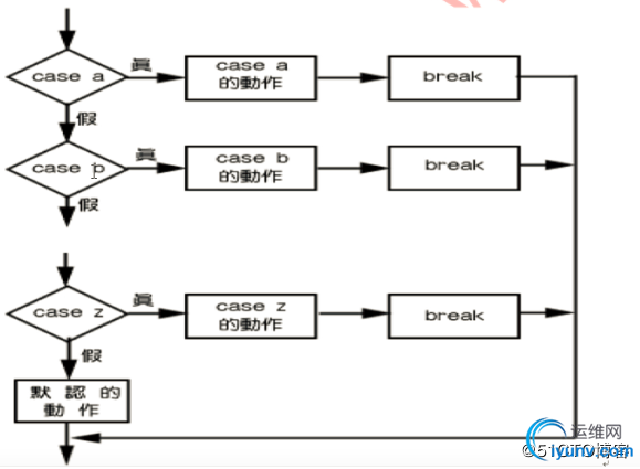

  四 case-for-while语句的使用方法
  case: 流程控制语句,适用于多分支。
  格式:
  case 变量 in
  字符串1)命令列表1
  字符串n)命令列表n
  esac
  举例说明:
  制作一个菜单,可以选择bcd,分别代表backup copy delete
  文字部分
  •   [root@localhost lianxi]# vim case.sh
  •   [root@localhost lianxi]# chmod +x case.sh
  •   [root@localhost lianxi]# ./case.sh     执行脚本
  •   Please selet you operation:
  •   1 Copy
  •   2 Delete
  •   3 Backup
  •   C                 我输入C
  •   your seletion is copy  说我选择的是copy
  •   1 Copy
  •   2 Delete
  •   3 Backup
  •   D
  •   your seletion is delete
  •   1 Copy
  •   2 Delete
  •   3 Backup
  •   B
  •   your seletion is backup
  •   [root@localhost lianxi]# cat case.sh
  •   #!/bin/bash
  •   echo "****************************"
  •   echo "Please selet you operation:"
  •   echo " 1 Copy"
  •   echo " 2 Delete"
  •   echo " 3 Backup"
  •   echo "*****************************"
  •   read op
  •   case $op in
  •   C)
  •   echo "your seletion is copy"
  •   D)
  •   echo "your seletion is delete"
  •   B)
  •   echo "your seletion is backup"
  •   *) # 参数*, 匹配所有参数。
  •   echo "invalide selection"
  •   esac
