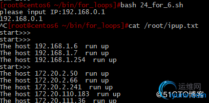

for((i=3,sum=0; i>/root/ipup.txt
  if [ $IPC -eq 0 ] ;then
  for IP1 in {0..254} ;do
  for IP2 in `seq 254`;do
  ping -c1 -w1  $IPCHECK$IP1.$IP2 &> /dev/null
  [ $? -eq 0 ] && echo "The host $IPCHECK$IP1.$IP2  run up" >> /root/ipup.txt
  done
  wait
  done
  else
  echo "your IP $IP is not available"
  fi
else
  echo "your IP $IP format is wrong"
fi

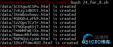

8、在/testdir目录下创建10个html文件,文件名格式为数字N(从1到10)加随机8个字母,如:1AbCdeFgH.html
for i in {1..10};do  NUM=`openssl rand -base64 6|tr -dc '[:alpha:]' |head -c10`
  touch /data/${i}${NUM}.html
done
unset NUM

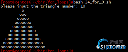

9、打印等腰三角形
read -p "please input the triangle number: " NUM
for n in `seq $NUM` ;do
  for a in `seq $[$NUM-$n]` ;do
  echo -n " "
  done
  for b in `seq $[2*$n-1]` ;do
  color=$[RANDOM%7+31]
  echo -en  "\033[1;${color}m*\033[0m"
  done
  echo
done

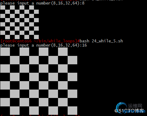

5、编写脚本,实现打印国际象棋棋盘
  默认背景色为黑色
clear
while read -p "please input a number(8,16,32,64):" num ;do
  if [[ $num =~ ^[0-9]{1,2}$ ]];then
  if [ $(($num%8)) -eq 0 ] ;then
  break
  fi
  else
  echo "Error:your input is illegal"
  fi
done
el=$[$num/4]
al=$[$num/8]
space=`seq $el |sed -r 's/\b[0-9]+\b//g'|tr "\n" " "`
for i in `seq $num`;do
  for j in {1..4};do
  if [[ $(($i%$el)) =~ ^[1-$al]$ ]] ;then
  echo -ne "\033[1;47m${space}\033[0m$space"
  else
  echo -ne "$space\033[1;47m${space}\033[0m"
  fi
  done
  echo
done
