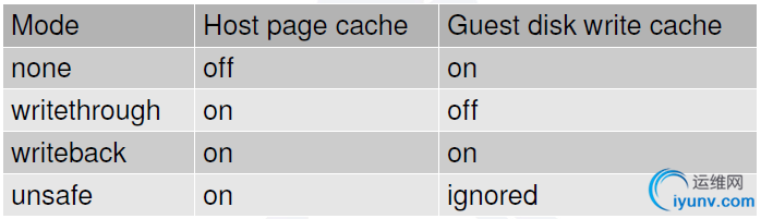

cache=method   Specifies the caching method for the drive. Possible values are unsafe, writethrough, writeback, directsync, or none.
  The operating system maintains a page cache to improve the storage I/O performance.
  • With the page cache, write operations to the storage system are considered completed after the data has been copied to the page cache.
  • Read operations can be satisfied from the page cache if the data requested is in the cache.
  • The page cache is copied to permanent storage using fsync(2).
  • Direct I/O requests bypass the page cache.
  In the KVM environment, both the host and guest operating systems can maintain their own page caches, resulting in two copies of data in memory.
  In general, it is better to bypass at least one of these page caches.
  If the application running in the guest is using direct I/O operations, then the guest cache would be bypassed.
  If the guest is set up with no caching, then the host page cache is bypassed, effectively turning all I/O operations from the guest into direct I/O operations on the host.
  • writethrough  writethrough mode is the default caching mode. With caching set to writethrough mode, the host page cache is enabled, but the disk write cache is disabled for the guest. Consequently, this caching mode ensures data integrity even if the applications and storage stack in the guest do not transfer data to permanent storage properly (either through fsync operations or file system barriers). Because the host page cache is enabled in this mode, the read performance for applications running in the guest is generally better. However, the write performance might be reduced because the disk write cache is disabled.
  • writeback  With caching set to writeback mode, both the host page cache and the disk write cache are enabled for the guest. Because of this, the I/O performance for applications running in the guest is good, but the data is not protected in a power failure. As a result, this caching mode is recommended only for temporary data where potential data loss is not a concern.
  • none  With caching mode set to none, the host page cache is disabled, but the disk write cache is enabled for the guest. In this mode, the write performance in the guest is optimal because write operations bypass the host page cache and go directly to the disk write cache. If the disk write cache is battery-backed, or if the applications or storage stack in the guest transfer data properly (either through fsync operations or file system barriers), then data integrity can be ensured. However, because the host page cache is disabled, the read performance in the guest would not be as good as in the modes where the host page cache is enabled, such as writethrough mode.
  • unsafe  Caching mode of unsafe ignores cache transfer operations completely. As its name implies, this caching mode should be used only for temporary data where data loss is not a concern. This mode can be useful for speeding up guest installations, but you should switch to another caching mode in production environments.
