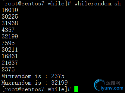

  3,生成10个随机数,并找出最大随机数和最小随机数
  #!/bin/bash
  #Author:wangjun
  #Contact QQ:183530300
  #Version:1.0
  #Create time:2016-08-17 20:22:58
  #Description:random number comparative
  minrandom=$RANDOM
  maxrandom=$minrandom
  declare -i R=1
  echo $minrandom
  while [[ $R -le 9 ]];do
  RD=$RANDOM
  echo $RD
  if [[ $RD -gt $maxrandom ]];then
  maxrandom=$RD
  elif [[ $RD -lt $minrandom ]];then
  minrandom=$RD
  fi
  let R++
  done
  echo "Minrandom is : $minrandom"
  echo "Maxrandom is : $maxrandom"
