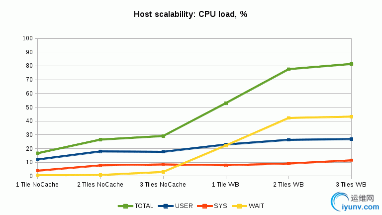

Host scaling: CPU
  How the host responds to the ever-increasing load? Lets start from CPU scaling:
  At first, it seems that the write-back cache comports a noticeable toll on CPU performance: even accounting for the increased speed, total CPU load is quite high.
  However, a deeper analysis show that increased CPU load is really due to the increased WAIT time, which is the time the CPU is spending waiting for the I/O subsystem to catch-up.
  Hey, wait a moment (no pun intended): why enabling the wb cache actually results in increased disk WAIT time? The fact is that the writeback cache enables much more parallelism in the I/O stack, resulting in the disk working much harder, and more threads are concurrently marked as “executable” by the scheduler.
  While CPU is waiting for I/O to complete, the process requesting the I/O operation is blocked, but the CPU is free to execute another thread. This means that real CPU load should be obtained summing USER and SYS loads, and in this case we see only a very mild increase in CPU load between the nocache and wb-cache scenarios (perfectly justified by the increased performance).
  In short: enabling the write-back cache is a non-issue from a CPU standpoint, at least when using buffered I/O (as is the case with direct access to LVM-based disks).

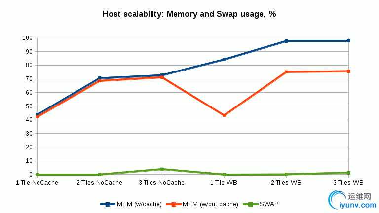

Host scalability: memory utilization
  Do using some RAM for caching lowers total free memory? Lets check:
  This chart really need an explanation. The “MEM (w/cache)” line shows total system memory usage, while the “MEM (w/out cache)” shows real memory utilization. The key concept here is that for Linux (and other modern OSes are the same) the memory used for caching and/or buffering is not really maked as “used memory”, as it can readily freed at any time.
  So, real memory utilization is depicted by the red line. Watching this line, you can see that the wb-cache is no more memory-hungry that the nocache configuration.
  In other words: Linux only engages unused memory for caching and, when an application requires more free memory, it immediately deallocs cache for giving the application the requested memory.
  The careful reader should have a question now: how it is possible for a 8 GB host machine to happily run as much as 12 virtual machines, for a total estimated guest memory usage of over 9 GB, without heavy swapping? The answer lie in a very useful Linux feature, called KSM (kernel samepage merging). KSM enable the host system to periodically check for duplicate memory chunks, and to deduplicate them when found. In short, if two memory locations have the same content, KSM marks the first location as a CoW (copy-on-write) one, and frees the second location. If an application want to modify the shared location, the system first re-duplicate it, and then modify the newly-created location.
  In practice KSM works surprisingly well, especially for short-lived Windows machines: as Windows has the habit of zeroing all free memory at startup, KSM has plenty of opportunities to coalesce these zeroed pages.
