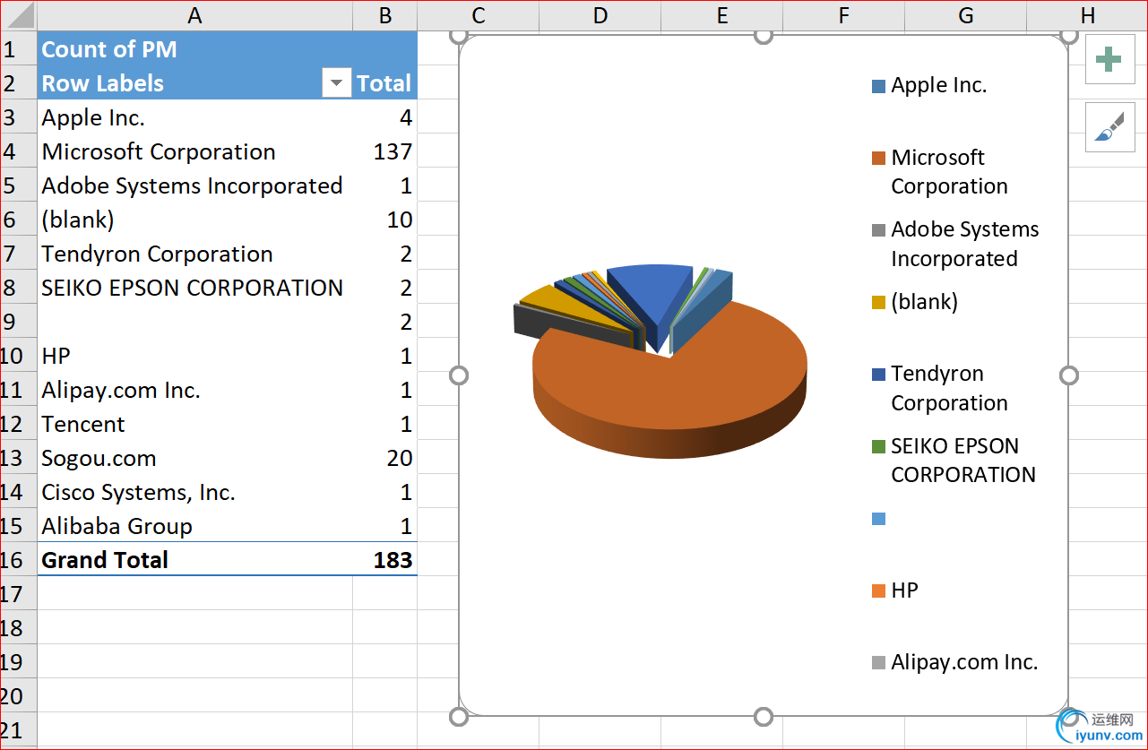

$ps = ps
$ps |
    Export-Excel .\testExport1.xlsx  -WorkSheetname memory `
        -IncludePivotTable -PivotRows Company -PivotData PM `
        -IncludePivotChart -ChartType PieExploded3D

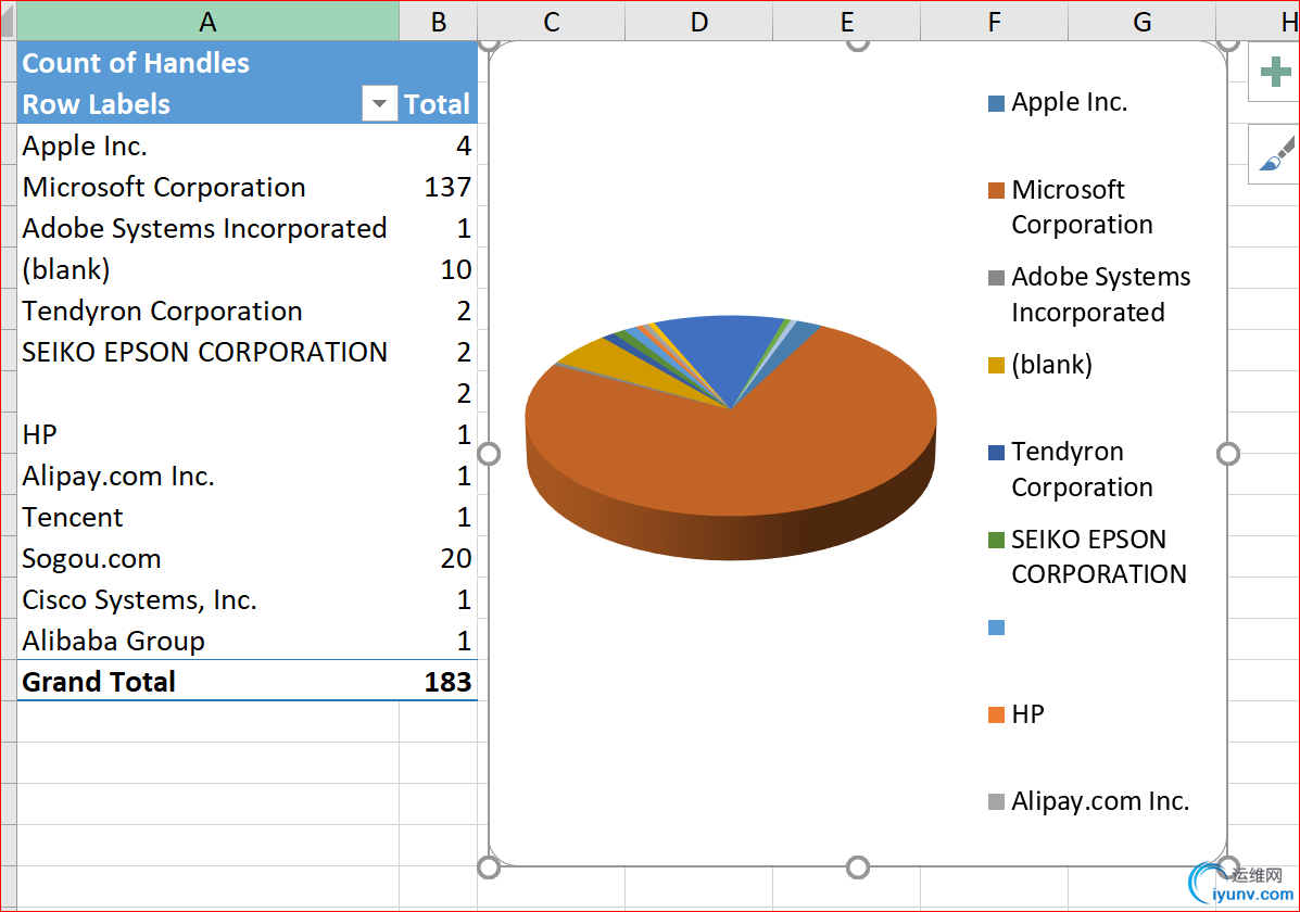

$ps |
    Export-Excel .\testExport1.xlsx  -WorkSheetname handles `
        -IncludePivotTable -PivotRows Company -PivotData Handles `
        -IncludePivotChart -ChartType PieExploded3D -Show
