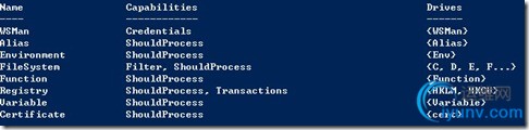

  This is what happened when I typed just:
  get-Psprovider
  Challenge: try
  PSProvider | get-member
