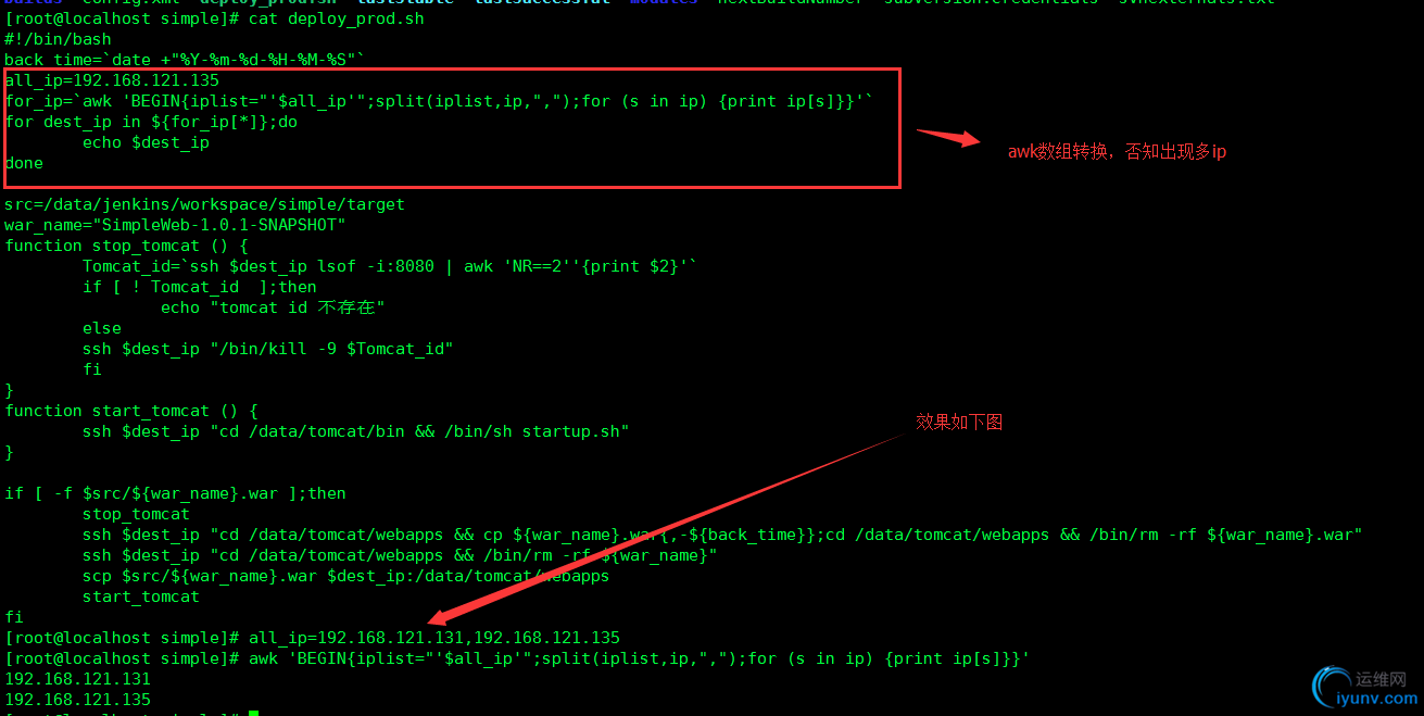

  脚本的内容:
  脚本使用的是scp命令,当然也可以使用wget等。
12345678910111213141516171819202122232425262728[root@localhost simple]# cat deploy_prod.sh #!/bin/bashback_time=`date +"%Y-%m-%d-%H-%M-%S"`#备份的时间all_ip=192.168.121.135for_ip=`awk 'BEGIN{iplist="'$all_ip'";split(iplist,ip,",");for (s in ip) {print ip}}'`  #awk数组转换for dest_ip in ${for_ip
  • };do    echo $dest_ipdonesrc=/data/jenkins/workspace/simple/target#下面就是重启scp的过程war_name="SimpleWeb-1.0.1-SNAPSHOT"function stop_tomcat () {    Tomcat_id=`ssh $dest_ip lsof -i:8080 | awk 'NR==2''{print $2}'`if [ ! Tomcat_id  ];then    echo "tomcat id 不存在"else    ssh $dest_ip "/bin/kill -9 $Tomcat_id"fi}function start_tomcat () {    ssh $dest_ip "cd /data/tomcat/bin && /bin/sh startup.sh"}if [ -f $src/${war_name}.war ];then    stop_tomcat    ssh $dest_ip "cd /data/tomcat/webapps && cp ${war_name}.war{,-${back_time}};cd /data/tomcat/webapps && /bin/rm -rf ${war_name}.war"    ssh $dest_ip "cd /data/tomcat/webapps && /bin/rm -rf ${war_name}"    scp $src/${war_name}.war $dest_ip:/data/tomcat/webapps    start_tomcat fi  数组转换防止出现多ip发布:
    1234[root@localhost simple]# all_ip=192.168.121.131,192.168.121.135[root@localhost simple]# awk 'BEGIN{iplist="'$all_ip'";split(iplist,ip,",");for (s in ip) {print ip}}'192.168.121.131192.168.121.135  效果如下图:

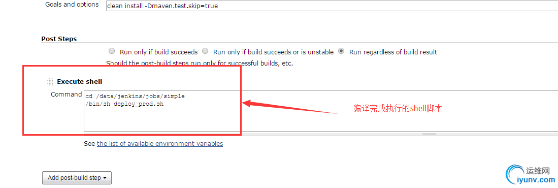

      添加构建的执行脚本(注意不是在构建完执行的那块加):

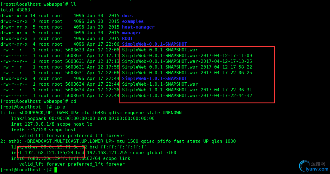

      运行job,build完后会执行deploy脚本:
      查看远程的tomcat是否发布完成:
