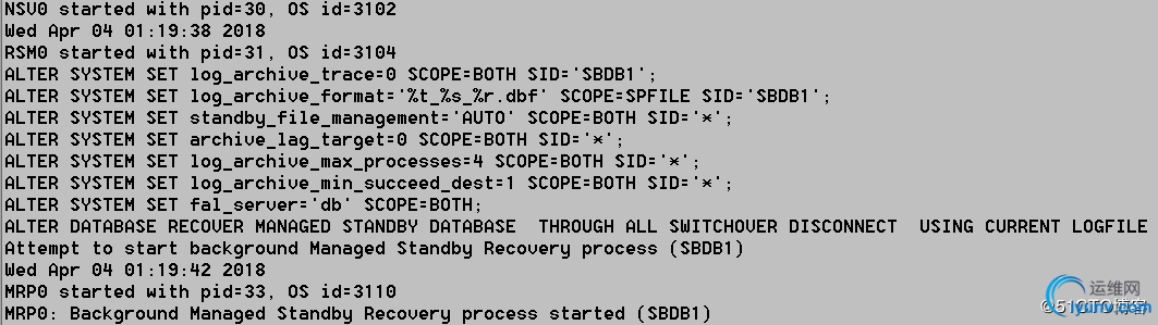

  同时检查alert_$ORACLE_SID.log日志可以看到:
RSM0 started with pid=48, OS>
ALTER SYSTEM SET log_archive_dest_1='location=USE_DB_RECOVERY_FILE_DEST','valid_for=(ALL_LOGFILES, ALL_ROLES)' SCOPE=BOTH;
ALTER SYSTEM SET log_archive_trace=0 SCOPE=BOTH SID='db1';
ALTER SYSTEM SET log_archive_format='%t_%s_%r.dbf' SCOPE=SPFILE SID='db1';
ALTER SYSTEM SET standby_file_management='AUTO' SCOPE=BOTH SID='*';
ALTER SYSTEM SET archive_lag_target=0 SCOPE=BOTH SID='*';
ALTER SYSTEM SET log_archive_max_processes=4 SCOPE=BOTH SID='*';
ALTER SYSTEM SET log_archive_min_succeed_dest=1 SCOPE=BOTH SID='*';
