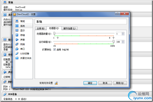

      4.1 Verify PAE mode is active. Under the VM settings, System > Processor Tab, make sure 'Enable PAE/NX' mode is checked.
