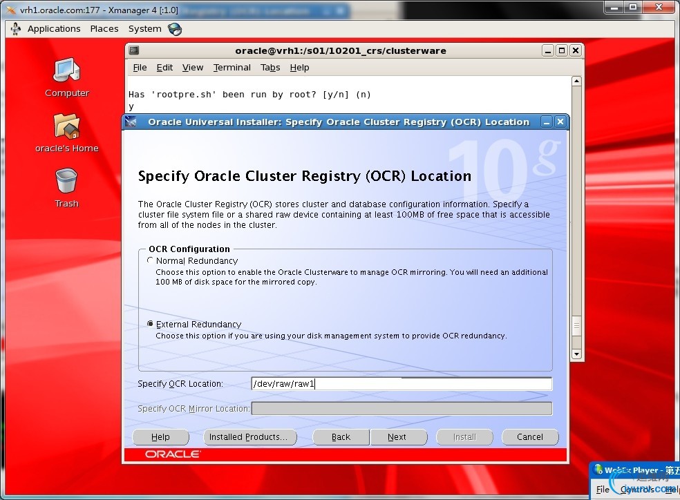

  先来做 ocr 和 Voting Disk
  解释下什么是ocr
  OCR - Oracle Cluster Registry(集群注册文件),记录每个节点的相关信息
  主要用作记录 不用分配很多空间
  Voting Disk
  Voting Disk - Establishes quorum (表决磁盘),仲裁机制用于仲裁多个节点向共享节点同时写的行为,这样做是为了避免发生冲突

  现在开始做裸设备
  裸设备 就是去除文件系统的限制 直接供给oracle 使用 个人理解
  cd /etc/udev/rules.d/
  ll
  -rw-r--r-- 1 root root   515 Jul 23  2011 05-udev-early.rules
  -rw-r--r-- 1 root root   992 Jul  9  2011 40-multipath.rules
  -rw-r--r-- 1 root root 16732 Jul 23  2011 50-udev.rules
  -rw-r--r-- 1 root root   471 Jul 23  2011 51-hotplug.rules
  -rw-r--r-- 1 root root 58016 Jun  7  2007 60-libsane.rules
  -rw-r--r-- 1 root root   143 Jun  8  2011 60-net.rules
  -rw-r--r-- 1 root root  1088 Jun  6  2007 60-pcmcia.rules
  -rw-r--r-- 1 root root   528 Sep 17 10:52 60-raw.rules
  -rw-r--r-- 1 root root  9366 Jul 23  2011 60-wacom.rules
  -rw-r--r-- 1 root root   129 Jul 23  2011 61-uinput-stddev.rules
  -rw-r--r-- 1 root root   214 Jul 23  2011 61-uinput-wacom.rules
  -rw-r--r-- 1 root root  1823 Nov  5  2008 85-pcscd_ccid.rules
  -rw-r--r-- 1 root root   175 Jul 23  2011 88-clock.rules
  -rw-r--r-- 1 root root   114 Nov  5  2008 90-alsa.rules
  -rw-r--r-- 1 root root    61 Jul 23  2011 90-dm.rules
  -rw-r--r-- 1 root root    82 Jan 14  2011 90-hal.rules
  -rw-r--r-- 1 root root   107 Jul 23  2011 95-pam-console.rules
  -rw-r--r-- 1 root root   292 May 11  2011 98-kexec.rules
  -rw-r--r-- 1 root root  2319 Jul 15  2008 bluetooth.rules
  vi 60-raw.rules #裸设备配置文件
  加入下面字段
  ACTION=="add", KERNEL=="sdb1", RUN+="/bin/raw /dev/raw/raw1 %N"
  ACTION=="add", KERNEL=="sdb2", RUN+="/bin/raw /dev/raw/raw2 %N"
  ACTION=="add", KERNEL=="raw*", OWNER=="oracle", GROUP=="oinstall", MODE=="0660"
  :wq
  start_udev #启动udev
  查看
  ll /dev/raw
  total 0
  crw-rw---- 1 oracle oinstall 162, 1 Sep 17 11:58 raw1
  crw-rw---- 1 oracle oinstall 162, 2 Sep 17 11:58 raw2

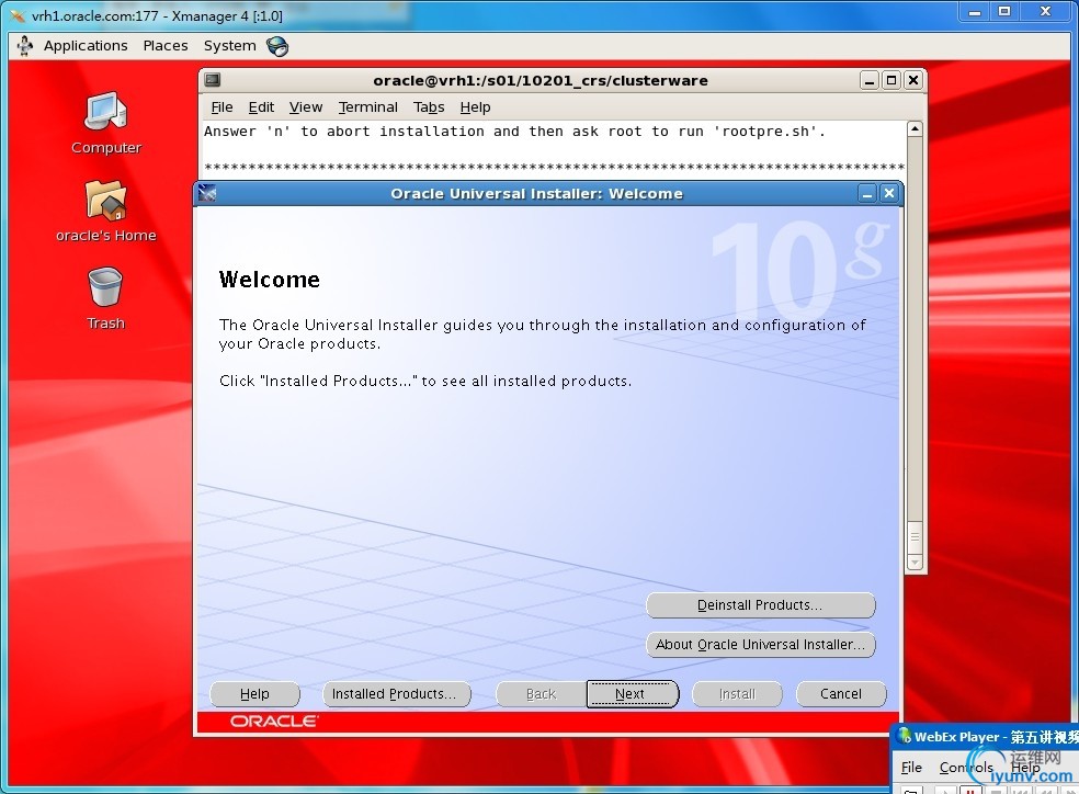

  执行 runInstaller
  报错
  [oracle@vrh1 clusterware]$ ./runInstaller
  Please run the script rootpre.sh as root on all machines/nodes. The script can be found at the toplevel of the CD or stage-area. Once you have run the script, please type Y to proceed
  Answer 'y' if root has run 'rootpre.sh' so you can proceed with Oracle Clusterware installation.
  Answer 'n' to abort installation and then ask root to run 'rootpre.sh'.
  Has 'rootpre.sh' been run by root? [y/n] (n)
  需要执行一个rootpre.sh 脚本 必须用root 用户去运行

  回到图形界面
  y
  Starting Oracle Universal Installer...
  Checking installer requirements...
