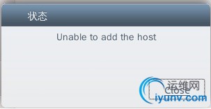

cloudstack主机添加不成功
  CloudStack正常启动,添加区域、提供点和群集都正常,但是添加主机时提示添加不成功。
  先添加主机:
  然后出现提示:

2013-06-27 09:07:19,659 INFO  [cloud.resource.ResourceManagerImpl] (catalina-exec-17:null) Trying to add a new host at http://192.168.74.143 in data center 3
2013-06-27 09:07:19,664 WARN  [kvm.discoverer.KvmServerDiscoverer] (catalina-exec-17:null)  can't setup agent, due to java.io.IOException: There was a problem while connecting to 192.168.74.143:22 - There was a problem while connecting to 192.168.74.143:22
2013-06-27 09:07:19,664 WARN  [cloud.resource.ResourceManagerImpl] (catalina-exec-17:null) Unable to find the server resources at http://192.168.74.143
2013-06-27 09:07:19,664 WARN  [api.commands.AddHostCmd] (catalina-exec-17:null) Exception:
com.cloud.exception.DiscoveryException: Unable to add the host

查看VT是否打开
  因为没打开VT,所以导致不能添加Host的异常,打开VT后,再次添加,添加成功!
