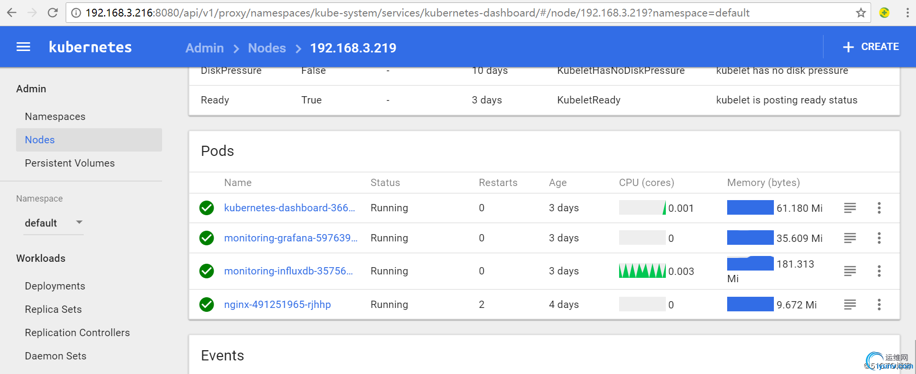

  启动服务
  [root@k8s_master heapster-1.3.0]# kubectl create -f deploy/kube-config/influxdb/
  删除服务
  [root@k8s_master heapster-1.3.0]# kubectl delete -f deploy/kube-config/influxdb/
  查看pod
  [root@k8s_master ~]# kubectl get pods --all-namespaces
NAMESPACE     NAME                                    READY     STATUS    RESTARTS   AGE
default       busybox                                 1/1       Running   93         3d
kube-system   heapster-4127054459-wzppn               1/1       Running   0          3d
kube-system   kube-dns-2074712928-dxv2q               4/4       Running   4          3d
kube-system   kubernetes-dashboard-3665076642-9z0jc   1/1       Running   0          3d
kube-system   monitoring-grafana-597639858-tqpf2      1/1       Running   0          3d
kube-system   monitoring-influxdb-3575671003-9rpkh    1/1       Running   0          3d
web           nginx-491251965-dp4xz                   1/1       Running   2          4d
web           nginx-491251965-rjhhp                   1/1       Running   2          4d
  打开浏览器http://192.168.3.216:8080/ui
