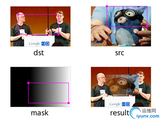

  下图就是几个相关的例子:
  mask 蒙版是渐变

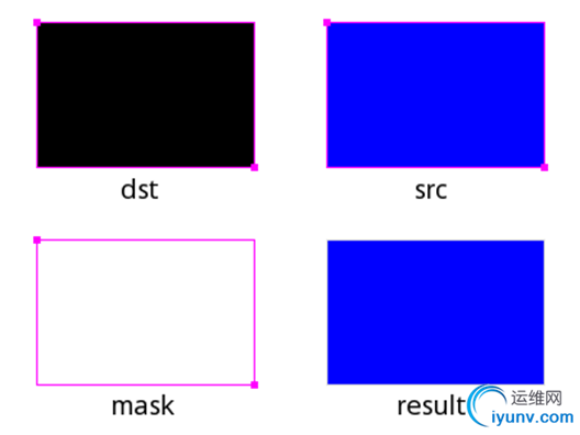

给一个矩形填充颜色
  使用 Draw方法的逻辑效果图:
  代码:
   1: m := image.NewRGBA(image.Rect(0, 0, 640, 480))
   2: blue := color.RGBA{0, 0, 255, 255}
   3: draw.Draw(m, m.Bounds(), &image.Uniform{blue}, image.ZP, draw.Src)

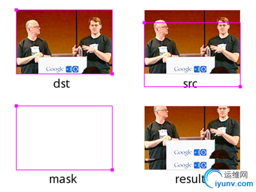

图片滚动效果
  效果如下图:
  假设我们需要把图片 m 上移20个像素.
  相关代码:
   1: b := m.Bounds()
   2: p := image.Pt(0, 20)
   3: // Note that even though the second argument is b,
   4: // the effective rectangle is smaller due to clipping.
   5: draw.Draw(m, b, m, b.Min.Add(p), draw.Src)
   6: dirtyRect := b.Intersect(image.Rect(b.Min.X, b.Max.Y-20, b.Max.X, b.Max.Y))

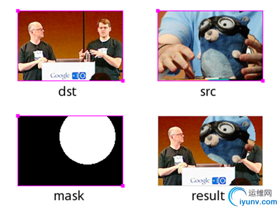

  23: draw.DrawMask(dst, dst.Bounds(), src, image.ZP, &circle{p, r}, image.ZP, draw.Over)
  注意,一个image对象只需要实现下面几个就可,这也就是Go接口强大的地方.
   1: type Image interface {
   2:     // ColorModel returns the Image's color model.
   3:     ColorModel() color.Model
   4:     // Bounds returns the domain for which At can return non-zero color.
   5:     // The bounds do not necessarily contain the point (0, 0).
   6:     Bounds() Rectangle
   7:     // At returns the color of the pixel at (x, y).
   8:     // At(Bounds().Min.X, Bounds().Min.Y) returns the upper-left pixel of the grid.
   9:     // At(Bounds().Max.X-1, Bounds().Max.Y-1) returns the lower-right one.
  10:     At(x, y int) color.Color
  11: }

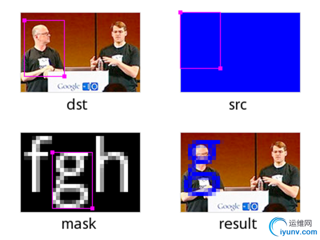

画一个字体
  效果图,画一个蓝色背景的字体。
  相关伪代码:
   1: src := &image.Uniform{color.RGBA{0, 0, 255, 255}}
   2: mask := theGlyphImageForAFont()
   3: mr := theBoundsFor(glyphIndex)
   4: draw.DrawMask(dst, mr.Sub(mr.Min).Add(p), src, image.ZP, mask, mr.Min, draw.Over)
  上面例子完整的代码请看:
  http://golang.org/doc/progs/image_draw.go
