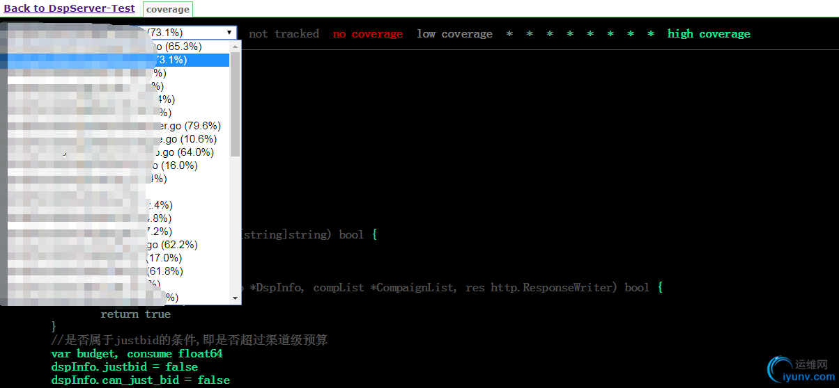

go tool cover -html=./coverage/coverage.cov -o /data/reports/coverage.html
./coverage/gocover-cobertura < coverage.cov > /data/reports/coverage.xml
  生成xml报告时需要安装一个小插件:go get github.com/t-yuki/gocover-cobertura
  将bin下的gocover-cobertura放到方便执行的目录下即可使用
  4 将测试报告集成到jenkins,大功告成啦
