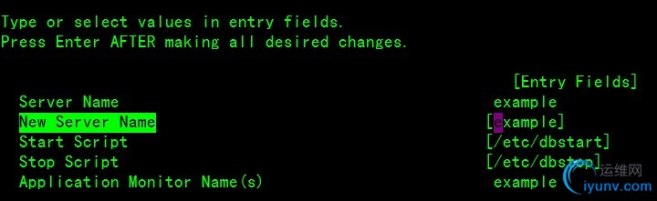

  2.Create start and stop scripts:
  • [root@dbserv1 /]#vi /etc/dbstart
  • #!/usr/bin/bash
  • #Define Oracle Home
  • ORACLE_HOME=/u01/app/oracle/product/11.2.0/dbhome_1
  • #Start Oracle Listener
  • if [ -x $ORACLE_HOME/bin/lsnrctl ]; then
  • su - oracle "-c lsnrctl start"
  • fi
  • #Start Oracle Instance
  • if [ -x $ORACLE_HOME/bin/sqlplus ]; then
  • su - oracle "-c sqlplus"Add an Application Server

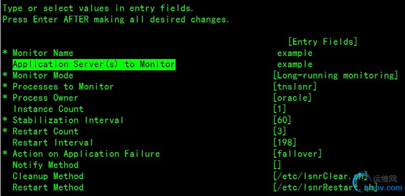

      2.Create Application Monitor:
      Extended Configuration->Extended Resource Configuration->Configure HACMP Application Servers->Configure HACMP Application Monitoring->Add a Process Application Monitor

    •          Application monitor of example: example
    •             Monitor name: example
    •                Type: process
    •                Process monitored: tnslsnr
    •                Process owner: oracle
    •                Instance count: 1
    •                Stabilization interval: 60 seconds
    •                Retry count: 3 tries
    •                Restart interval: 198 seconds
    •                Failure action: fallover
    •                Cleanup method: /etc/lsnrClear.sh
