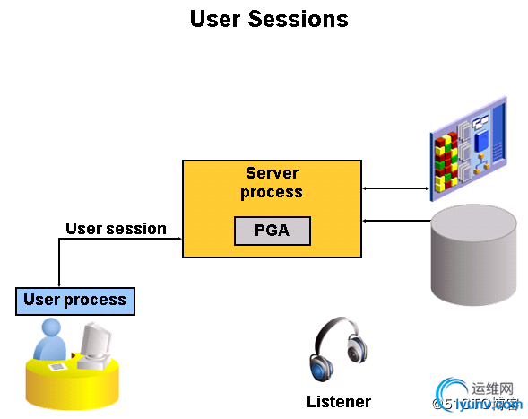

  仅限共享模式:SGA->UGA
  When Not to Use a Shared Server
  Certain types of database work must not be performed using shared servers:
  a. Database administration
  b. Backup and recovery operations
  c. Batch processing and bulk load operations
  d. Data warehouse operations
