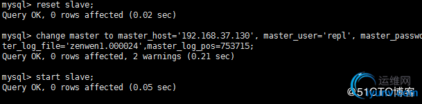

#mysql -uroot
stop slave;
change master to master_host='192.168.37.130', master_user='repl', master_password='5650895', master_log_file='zenwen1.000024',master_log_pos=753715;
start slave;

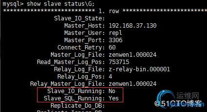

从上执行 mysql -uroot
show slave stauts\G
  查看报错日志,发现原因
2018-01-10 14:55:18 4470 [ERROR] Slave I/O: Fatal error: The slave I/O thread stops because master and slave have equal MySQL server UUIDs; these UUIDs must be different for replication to work. Error_code: 1593

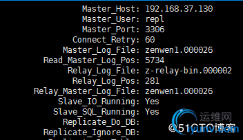

找到原因,是因为使用的克隆的原因,执行操作
#cd /data/mysql/
#mv auto.cnf  auto.cnf.bak
#/etc/init.d/mysqld restart
  看是否有
  Slave_IO_Running: Yes
  Slave_SQL_Running: Yes
