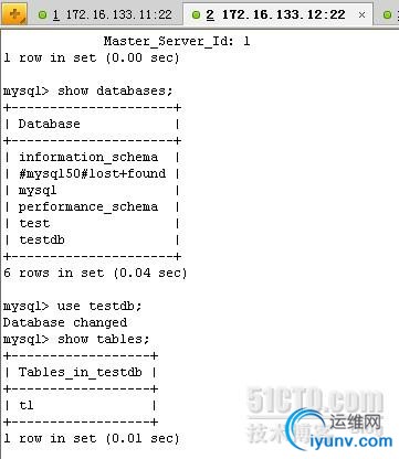

  然后就算配置完成了,可以在node1中建立一个测试数据库testdb,和一个测试表t1
进入node2的mysql查看

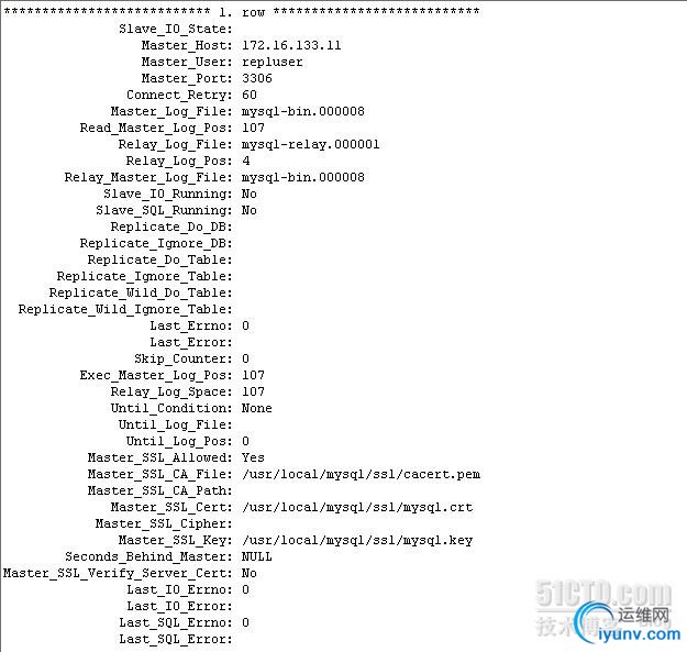

mysql>slave stop;
mysql>reset slave;
mysql>change master to master_host='172.16.133.11',master_user='repluser',master_password='redhat',master_log_file='mysql-bin.000008',master_log_pos=107,master_ssl=1,master_ssl_ca='/usr/local/mysql/ssl/cacert.pem',master_ssl_cert='/usr/local/mysql/ssl/mysql.crt',master_ssl_key='/usr/local/mysql/ssl/mysql.key';
mysql>show slave status\G

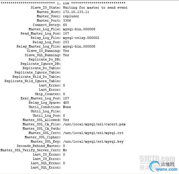

mysql>slave start;
说明基于ssl的mysql主从复制已配置成功
