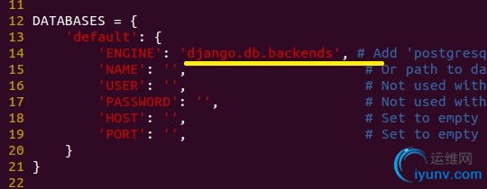

  问题 1
  raise ImproperlyConfigured("settings.DATABASES is improperly configured. " django.core.exceptions.ImproperlyConfigured: settings.DATABASES is improperly configured. Please supply the ENGINE value. Check settings documentation for more details.
  确认DATABASES节点中配置是否正常,如:
  检查是否有多个settings.py文件.如果是逐个检查对应节点.
